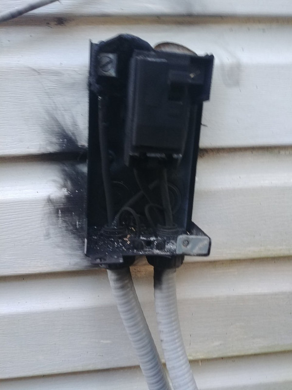

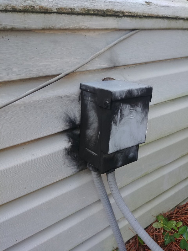

Came across this one yesterday on a service call after a bad storm. I have been doing HVAC work for a long time and have seen it this bad a few times, but there is a twist with this one. This is an electrical disconnect for the outdoor AC condenser. It clearly took a voltage surge, highly likely lightning inspired. I turned off the breaker at the main panel that feeds it and replaced it. So with the breaker in the house still off and the pull removed from the disconnect I just replaced, I began checking over the outdoor unit. I started pulling wires off the contactor to check various parts and got zapped (shocked) pretty good. How is that possible? It took a while but I finally realized that electricity was somehow energizing the unit through the copper line-set that goes to the indoor air handler. The indoor Air handler still worked and after removing power from it, the outdoor unit still had voltage on it! I told them to call an electrician. The outdoor unit is toast so we will likely be replacing the entire system sometime this week.
Post by ryan_ott on Jul 26, 2020 22:17:44 GMT -5
That’s a nice one! I get plenty of generator controls smoked like that from surges. Improper wiring of receptacles will cause back feed issues swapping grounds and neutrals, broken wires, loose wires on back stabbed receptacles, also heating elements ie: electric dryer, stove top, etc can have it swap to the other side of the panel. Fun stuff...
