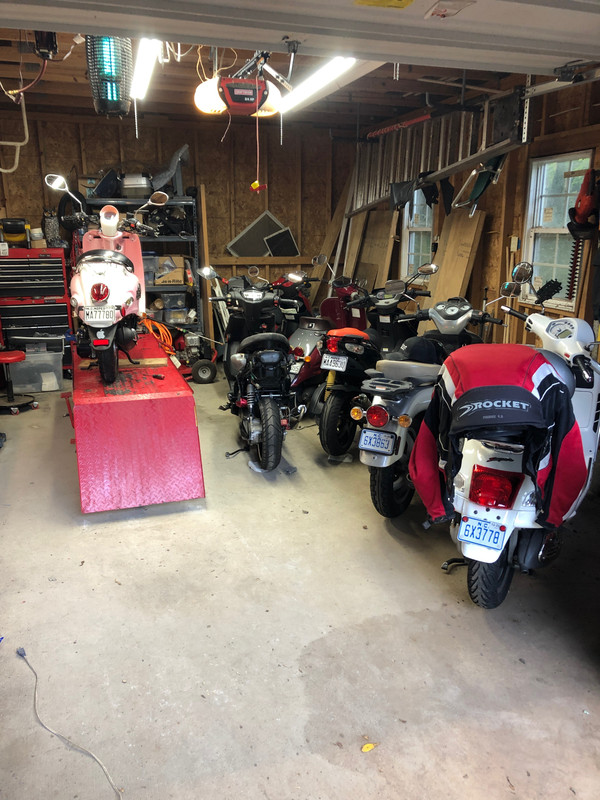

Post by pinkscoot on Sept 19, 2020 18:28:40 GMT -5
I played on this some more. I put a thermometer on it thinking it was a heat issue. The themps stabilize at 250-260F so the 94 main jet is good. The idle it drops a little but not much. The plug looks good. I know the no start is in the idle circuit because when I open the throttle it starts then will idle. With the choke on it idles at 4000rpm so Maybe I just need to richen the idle up. It's getting better I just need to get some of these scoots out of the garage:
I just realized I missed the ET4 by the door.
