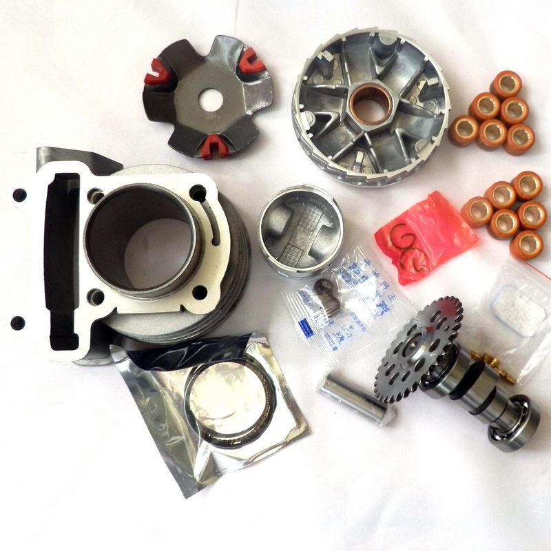

Post by wolfvalentine on Dec 1, 2016 21:40:26 GMT -5
SO WHAT ABOUT THIS PACK

Post by wolfvalentine on Dec 5, 2016 17:33:24 GMT -5
HOW ABOUT THIS POWER PACK ANY GOOD?

Post by Deleted on Dec 5, 2016 21:23:57 GMT -5
It looks like the same generic crap everyone sells
Post by gsx600racer on Dec 5, 2016 21:36:37 GMT -5
HOW ABOUT THIS POWER PACK ANY GOOD? Only thing missing is a crank shaft and jets to tune the carb. My guess is you like pretty colors and shiny things.
Post by 90GTVert on Dec 6, 2016 7:16:02 GMT -5
Most of the kits are fine, and most are the same generic stuff. I think I said it before, but BBK, cam, variator, and then dialing in the carb and CVT are the things where you should see the most gains. Find a kit with that stuff or buy individually. One thing that has a bad rep are cheap variators. DLH and Koso are the most notorious, but I'm sure there are others made the same with different or no stamps on them. They fail quickly for many. With cheap BBKs, the most common issue I know of is piston rings. If you do have a problem, you can buy Taiwan made rings. The kits that have some tuning parts will give you a start at collecting bits to get in tune. I suspect most roller kits won't be the best quality, and I like sliders anyway.
Exhaust, air filter, etc... is fine to install, just probably not the most for your money. You have to look around and figure out exactly what you want and what you want to pay for.
