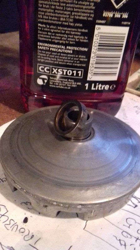

So this weeks little problem,my front brake lever was not returning to fully off so the brake light was staying on unless I pushed it back manually,after a little head scratching it turns out that my brake cylinder valve was sticking.A strip down revealed some gunk in there and after a clean all seems to be fine,I did have a problem with a stuck brake piston which I could not move untill I connected the system up and clamped the free one closed, the pressure from the caliper popped it out I cleaned years of grime off it, back in working fine. geoff in took this picture a while ago but this is the original restrictor ring as fitted by Yamaha .

So this weeks little problem,my front brake lever was not returning to fully off so the brake light was staying on unless I pushed it back manually,after a little head scratching it turns out that my brake cylinder valve was sticking.A strip down revealed some gunk in there and after a clean all seems to be fine,I did have a problem with a stuck brake piston which I could not move untill I connected the system up and clamped the free one closed, the pressure from the caliper popped it out I cleaned years of grime off it, back in working fine. geoff in took this picture a while ago but this is the original restrictor ring as fitted by Yamaha . Would love to know if you used old seals after stripping down the brake caliper, my handle is squishy too, no matter how much I bleed the brakes it's the same.
Post by geoffh on Sept 19, 2018 14:48:05 GMT -5
Errmkk,no new seals used but I use a syringe to pull the fluid through the system use the directory for brake bleeding tips my method is in there
