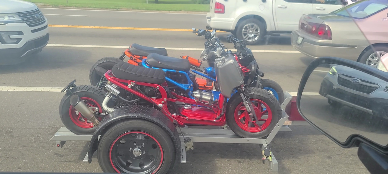

Met build for the wife is complete. Ruckus swingarm, gears, exhaust chop, sliders, velocity stack and a few other upgrades.

WERE YOU AT THE SMOKY MOUNTAIN SMALL BORE RALLY 2022 BECAUSE WE WERE AND I RECOGNIZED YOUR BIKES OR I THINK THESE ARE YOURS
WE ARE FROM CENTRAL KENTUCKY AND KNOWN AS MR ORIGINAL CONCEPT GARAGE YOUTUBE CHANNEL AND FACEBOOK PAGE FOR OUR 232CC 4VALVE WATERCOOLED GY6 SWAPPED HONDA RUCKUS. WHICH I HAVE SEEN YOUR BUILDS AND MODELED MINE AFTER YOURS AS ITS SUCH AN HONNOR TO FIGURE OUT HOW TO REACH OUT TO YOU!
