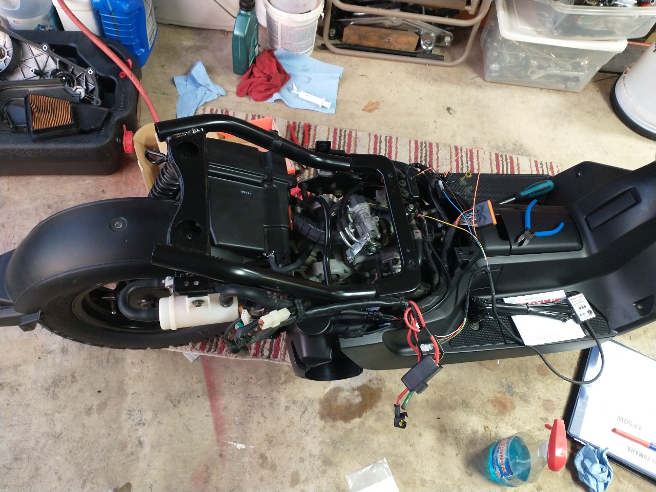

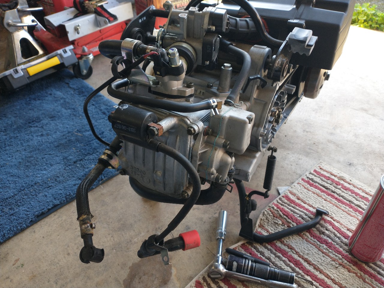

Pictures from Wednesday. Got the engine buttoned up and reinstalled on the frame. Started to get the tuner wired up, but stopped for the evening when my stomach started growl.

Today. I got the wiring for the Malossi tuner finished. It starts and idles. I was going to toss the seat lid on and take it for a quick spin around the block, but i heard thunder and didn't really feel like getting rained on. I'll probably finish buttoning up the panels and all that on Saturday, then take it out for a shakedown, then work on getting the variator and clutch installed and tuned. I was looking through the owner's manual to see if Yamaha specified any special type of coolant and and caught this out the corner of my eye. Apparently, there is a cat in the exhaust.

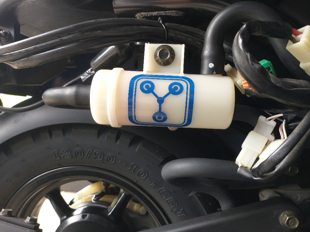

Went ahead and reconnected the flux capacitor... I also pulled the Reveno clutch off and reinstalled the stock one. The engagement on the Reveno is just too harsh if you are maneuvering or taking off in a confined area, or on gravel. I may check with what his name from Rolling Wrench and see if there is any way to tune the Reveno.
