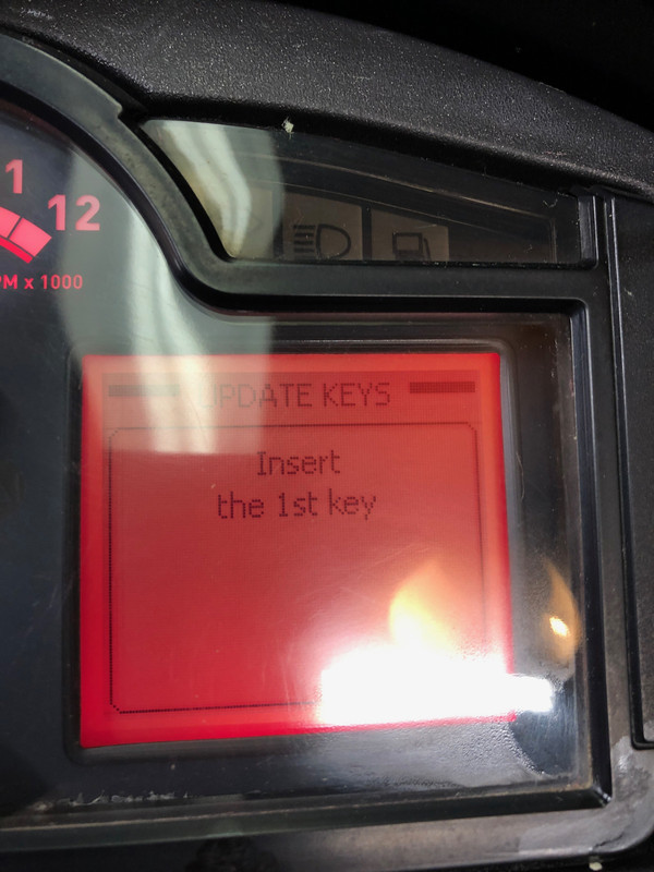

Today I got the engine back together new compressor o-ring, Malossi reeds, Rollers, belt and fuel filter. After putting the ECU in I needed to reset the ECU errors on the dash and reset the service. I decided to program my cheap transponder key while I was there. Big mistake, it wasn't a legit key so it just sat on the screen:  Tried pulling the battery, no luck. Tried pulling ECU, no luck. Texted the SR50 guru in Asheville and his fix was to get a legit transponder key. Thats what I get for being cheap. $32 later and 3 days shipping I should have it. Until then I'm dead in the water. The scoot does nothing. I should have waited until I had it running and took it out to see how it does. Maybe I'll put some body parts on until then.

Well I got the Aprilia key and stuck it in the antenna I pulled off the old lock set and it found it. It's smart again. I cleared all the codes again and reset the Throttle Position Sensor (TPS). It started up, though it hiccups for a few seconds then purrs like a kitten, no idle or A/F ratio to set. I took it out for a run up and down the street, it handled like s*** until I put air in the tires. I knew there was something I was going to do. It hit 32mph pretty easy and revved up nice. I pulled the plug and it looked a little rich but better that then lean. I may have over oiled the air filter, I'll look tomorrow. I decided it was safe to put the plastics on. That was a huge PITA. It's all set now and ready to run. Tomorrow I'll take it for a ride and see what it will do. More tomorrow with pictures.

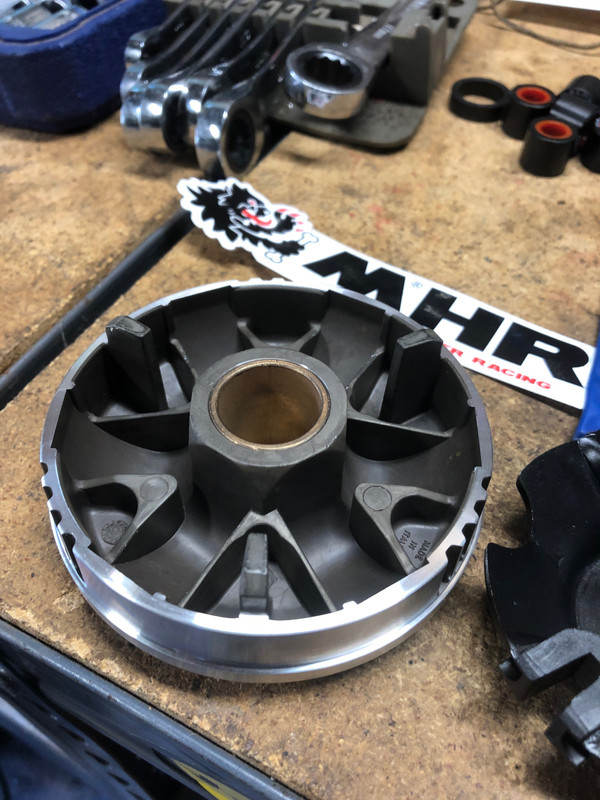

Its a nice looking variator teflon coated big guides to get the pulleys closed. I put it on with the 4 gram rollers and purple contra spring. Buttoned it up and took it for a ride. It was a dog, it was like starting in 2nd gear. Opened it up and found the belt sitting down in the pulley.  The clutch was engaging at 3200 rpm. I tried stiffer clutch springs and got it engaging at 4000rpm. The engine revved to 10,000 rpm, but still a dog. I went back to the stock variator with a thinner and longer boss with 5gram rollers and kept the purple contra and yellow springs. It was better than it was before but the belt was still too short. I did some research, the stock belt is 810 and there is a Malossi belt that is 820-18.5-30. I'm thinking it would be better but still a little on the short side. Maybe 825-18-30 would be the magic size. I'll let you know how it works out.

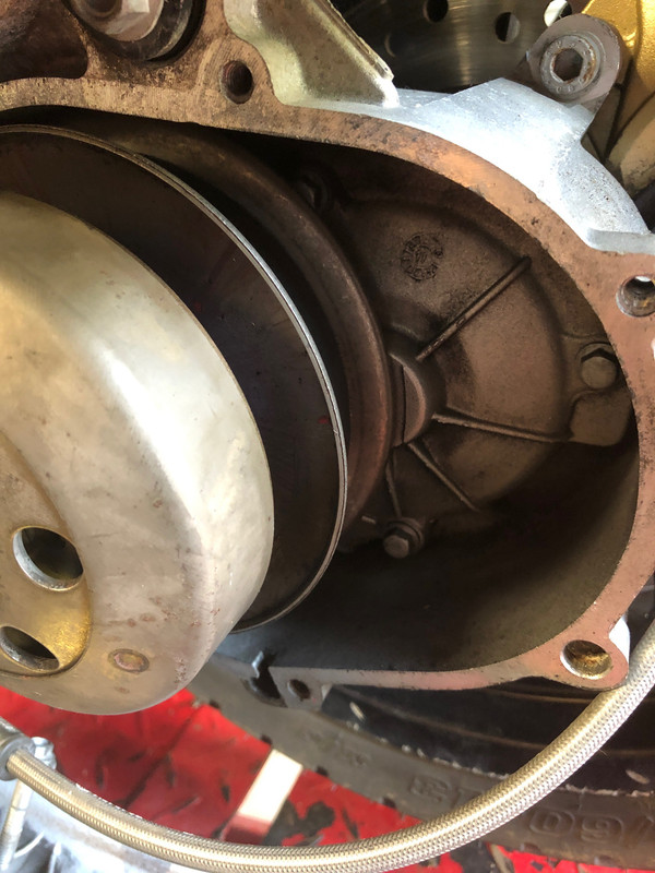

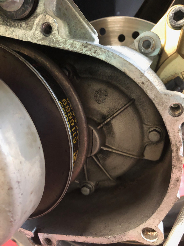

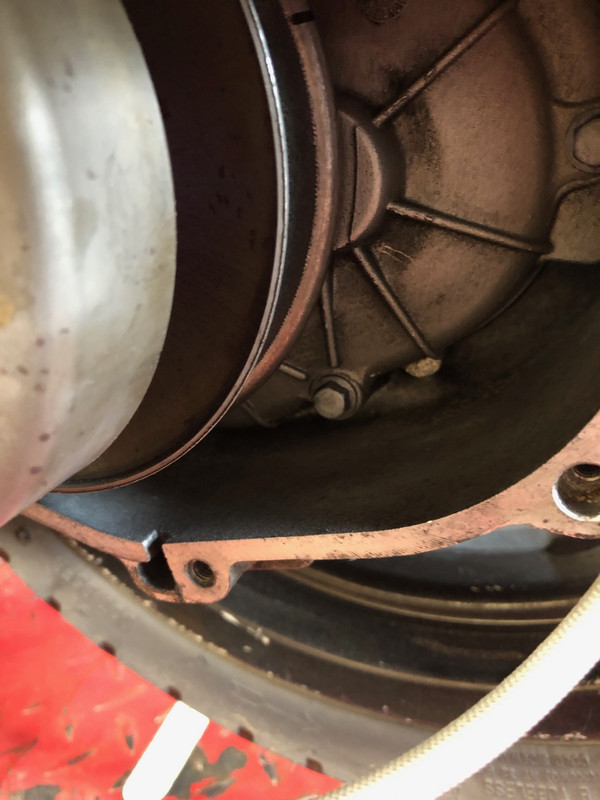

I was able to get a new Malossi belt that's a little longer by 10mm from the stock. I pulled the CVT cover and put the Multivar back in with the new belt. Still a dog, barely got to 35mph and it was like I was starting in 3rd gear. the marks on the variation left about 10mm and there was as much left to the outside of the clutch:   I went ahead and put the stock variator in with the Malossi belt and it was a world of difference. I did a run on the only level straight road in this town and hit 48mph one way and 50MPH the other. It feels like its in like 1 1/2 gear when I start, better than before. The problem is that the belt is about 1mm wider that the boss so it never sits down on the boss. Either need spacers or a narrower belt. What I have now is an 820X18.5 I'm thinking the one Brent uses that's for Overange which is 816X17.5 they are both 30deg. The big difference with the Multivar and stock is I only have 3.8gr. for the cultivar and 5gr for the stock. Maybe I should get some 5 and 4.5 grams for the Multivar and see where I am. With spacers I could play to find that perfect place to be. Time to look for spacers.

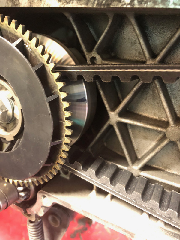

I was able to find some tuning time Friday, it was a little wet so I was only able to work on take off. Take off is the biggest problem right now so I'll work on speed when I'm happy with that. So I opened it up and pulled the stock variator off and played with the Multivar. I tested the belt with the pulley closed and it will get full travel plus some, with my oil pump there I really need to keep the belt travel no more than the variator. As I put the shims on I found 4 of them let the belt be all the way down and I still was able to get the nut on:  I went ahead and put the shims on the back side so I wouldn't have problems with them binding or disturbing the belt. I tried the 5gram rollers and it was not great, slow take off but 9-10K rpm. I then changed to the 4.5 gram rollers. When I opened it up I saw I had perfect travel on the clutch:  The 4.5 gram were worse but 10k rpm so I jumped to 7.2 gram and I was much better. The ride was okay but it would decelerate funny. I then remembered I was running the purple contra spring that came with the multivar. I of course was out of time. I have a lighter contra spring to go to so my next tuning I'll go to that and try the the 5gram rollers. I'm tempted to pull the Delta clutch off the S50 and play with that but I really like the way the S50 runs. Maybe when I sell the BV250 I'll get a Delta clutch for the SR50. I'm off Tuesday so I'll have plenty of time to play.
