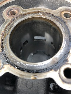

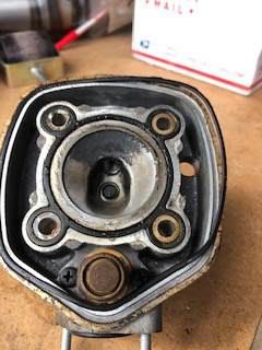

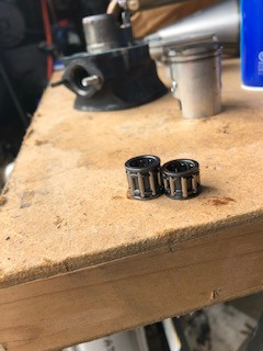

So with no shows in any of our theaters I now work 10-6 Monday through Friday. Though its only 40 hours a week and 5 day week it seems like I'm working more. But I do know I'll be home by 6:05 and have my weekends. That said and social distancing I was able to get in the garage today and start the install of the BBK. I had previously pulled the engine and cleaned everything up. So I was able to just start. I pulled the injector off and cleaned it and got everything off the old head and cleaned.

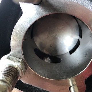

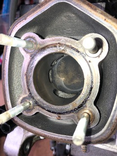

I pulled the head and it was surprisingly clean for 6 years and 9000 miles.
I could swear I saw swirls on the cylinder

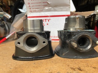

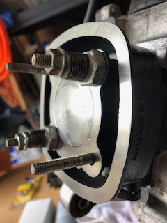

Not too much carbon for the use. It must burn pretty clean. The skirt on the new cylinder is a little shorter and the old wrist pin bearing is smaller.   All went well except I lost the base gasket that I found after cutting a new one. The ports lined up well, I didn't take measurements or get durations. I really just want this done and off the lift. Here is the piston at tDC and BDC.

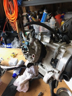

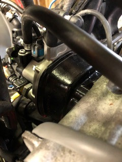

Everything slid together smoothly and I was able to get it back together, I decided to live dangerously and not do a leak down test. I didn't have the right size plugs and wanted to avoid a trip out, so we'll see if that was a mistake. Putting the engine back in was a bitch, I hadn't noticed when I pulled it that it doesn't fit between the mounts but sits offset to them so it was too far to the right and the bolt wouldn't go in. After I corrected that all was good. Here is it installed

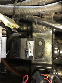

The last picture is the piggyback CDI that's used to adjust the injection and timing for the larger cylinder. This was a pretty painless install, there is a guy with a YouTube video of installing it with the engine left in, I think that had to have been harder than pulling it. Tomorrow night I'll get the fluids in and rest the Throttle body and give it a start and see if it was a success. Then CVT tuning and I'll have a runner.

Awesome work That is a clean cylinder after that many miles . The exhaust port looks close too brand new . Liquid cooling must make a big difference . What is you oil or oils of choice ?
Post by tiny on Mar 22, 2020 19:55:05 GMT -5
Aren't those engines twin spark plug and direct injection? If so that explains why it's so clean on the inside.
Post by pinkscoot on Mar 24, 2020 8:07:15 GMT -5
It only has a single plug but it is direct injection. I use Royal Purple but I don't know what the PO used.
