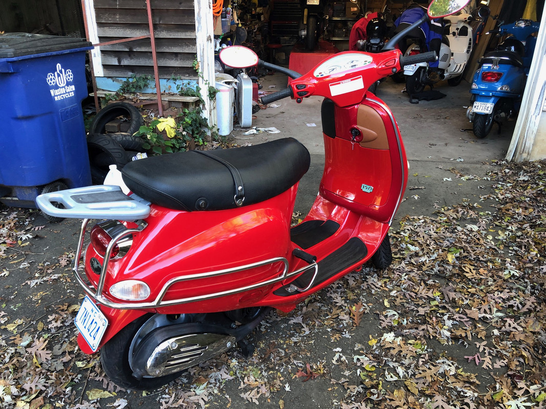

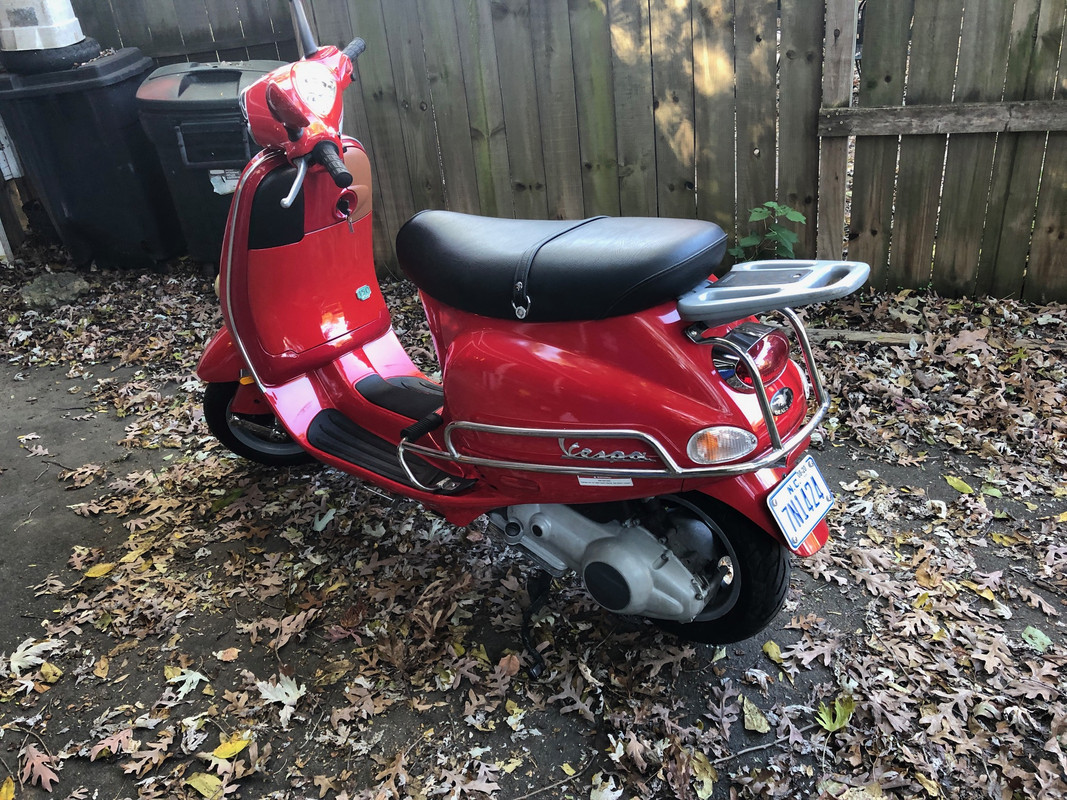

Post by pinkscoot on Nov 6, 2019 14:36:31 GMT -5
here are the pictures I promised: They no longer make the RH cover in black so I went with the brown. I do like it so I'll probably get a brown left hand next order fro AF1.
Post by jloi on Nov 6, 2019 23:14:40 GMT -5
the brown looks good I think . that is one seriously beautiful scooter
