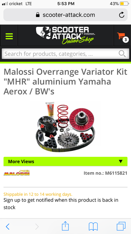

Tired of playing games.. “La Furia Rossa” ordered. I’ve already had to grind the case a little to get the Stage 6 SSP riser to fit properly, guess I’ll have to bust it out again and do some grinding in the CVT area. If anyone has installed this kit on Minerelli shortcase or on a bugeye Zuma, feel free to chime in any additional input as to anything special it needs. I haven’t had a chance to try out the new Powerjets yet (sizes 26 and 0) I want to try and use the Malossi E13 pod filter before I re-plumb the stock airbox, but before I do that, the CVT set up that’s stock on 02-05 is just downright horrible. I’m hoping tuning with the new kit matched with 15/50 gears will put the bike where I want it. The last major mods I may do to the bike are an aftermarket clutch and digital iggy. But one thing at a time as they say.

I’m glad I went with the aluminum TD Malossi offers instead of the one that failed on your trip. I really wonder how that happened? It must’ve been the welds. The price difference in the regular Malossi OR kit and this Aluminum “La Furia Rossa” one wasn’t much of a difference (on ScooterAttack at least).
