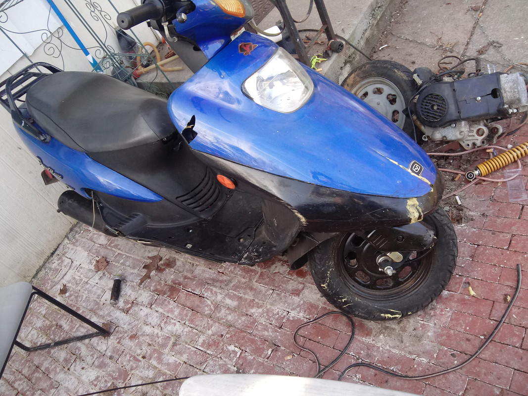

Post by kj4spj on Jun 17, 2019 16:12:04 GMT -5
I plastic welded my fairing using a 80 watt soldering iron and soda cap.i putting wire mesh behind it for support and strength. as you can see I was able to fill in the entire hole then I stand it to try to get it a smooth to the original surface.just was wondering is anybody ever tried this technique before and would it last?seems strong and able to flex with the fairing quite nicely.

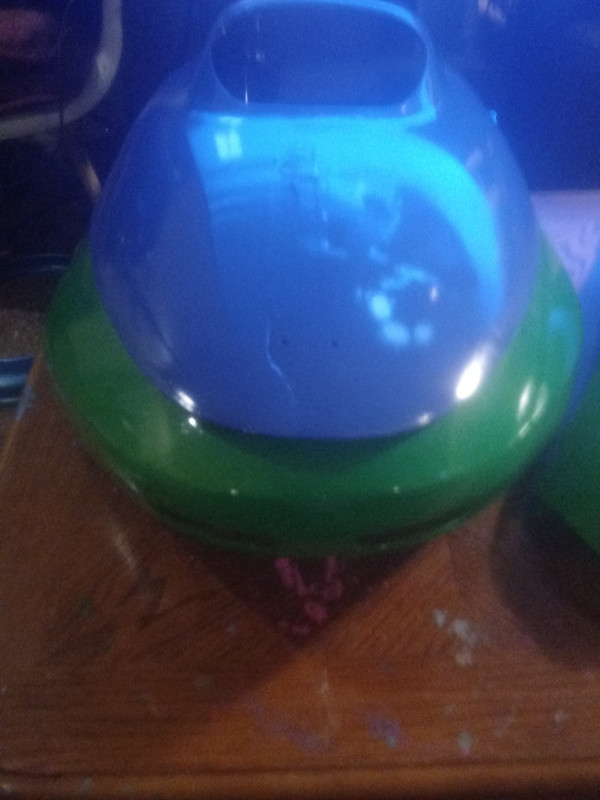

Post by kj4spj on Jun 17, 2019 20:09:34 GMT -5
very cool you don't happen to have any advice about painting.I've sanded it down to a quite smooth finished. now I just got to figure out which paint to use

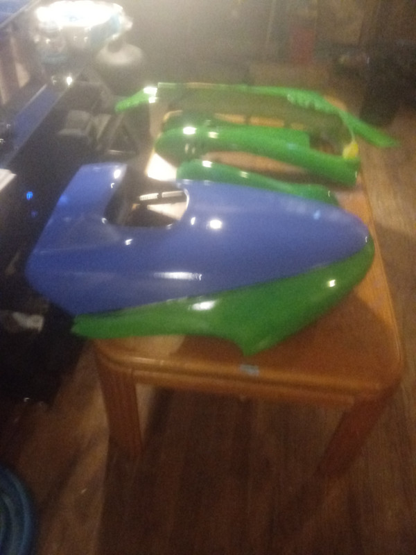

Post by kj4spj on Jul 12, 2019 19:17:05 GMT -5
finally did all my paint and looking GOOD

Post by jbjhillbilly on Jul 12, 2019 22:55:19 GMT -5
finally did all my paint and looking GOOD Well done! That looks very clean from what I can see in the pics.

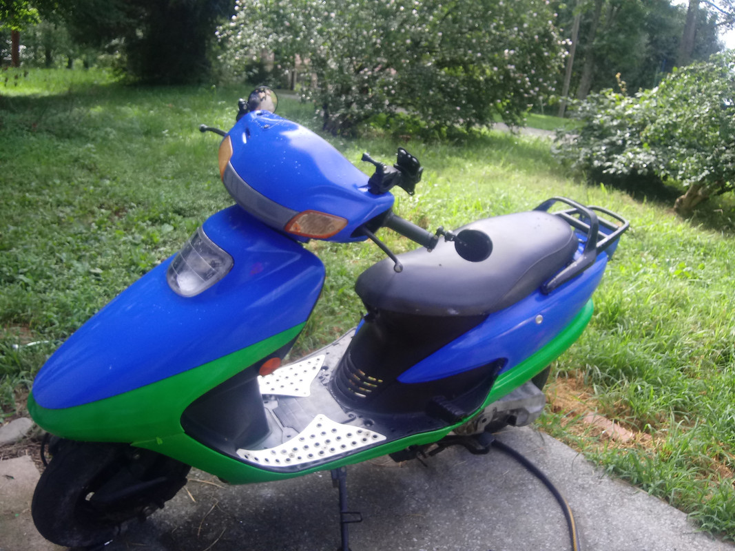

Post by kj4spj on Jul 14, 2019 18:38:12 GMT -5
finally got done with all the work and painting
Post by 90GTVert on Jul 21, 2019 14:36:14 GMT -5
Looks good. Thank you for making those videos for us. When I have tried this, I was definitely thinking things had to be melted way more than what you showed. If you're still looking for a free video editor, check out Shotcut. The posting part you're doing fine with using YouTube. I edited your posts and put all 3 vids together in 1 post in order. Thanks again!
