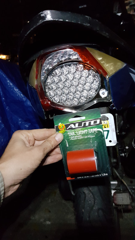

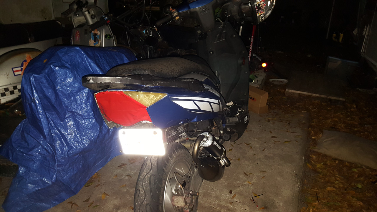

Yeah, this pipe is better... much better! Still quiet, Tecnigas makes a good silencer that's for sure. Has a much harder "punch" when it gets on the pipe. I'm looking at taller gears now. Here's a lil video of me riding to work today with sounds samples and obviously the horrible Florida drivers: Sorry, it's an older GoPro 960 haha so the quality isn't the best. The speedometer reads a hair under GPS. (41mph GPS, indicated 40mph). You can see how fast this thing gets up to speed... keep in mind this is a larger 150cc GY6 frame style/body and not a smaller sport style like we normally see. I also had the time to run to WalMart and grab some translucent red tape for the tail light that was busted out by asshat... actually turned out better than I expected! If anybody ever sees the stock tail light lens or assembly, let me know PLEASE! They are the same between the Eton Matrix 50 and 150cc.

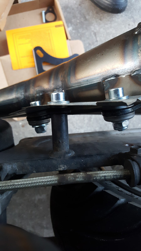

Had my first issue with the build yesterday too... was going to lunch and got a NASTY vibration/resonance coming from the cylinder area. Still had good power, didn't feel sputtery or anything so I pulled over and idling fine. Strange. Start looking around and found one of the exhaust flange bolts was loose, that's all. The sound was the exhaust leak at 9500 rpms haha it was definitely weird.
Post by dexameth on Feb 13, 2020 10:12:31 GMT -5

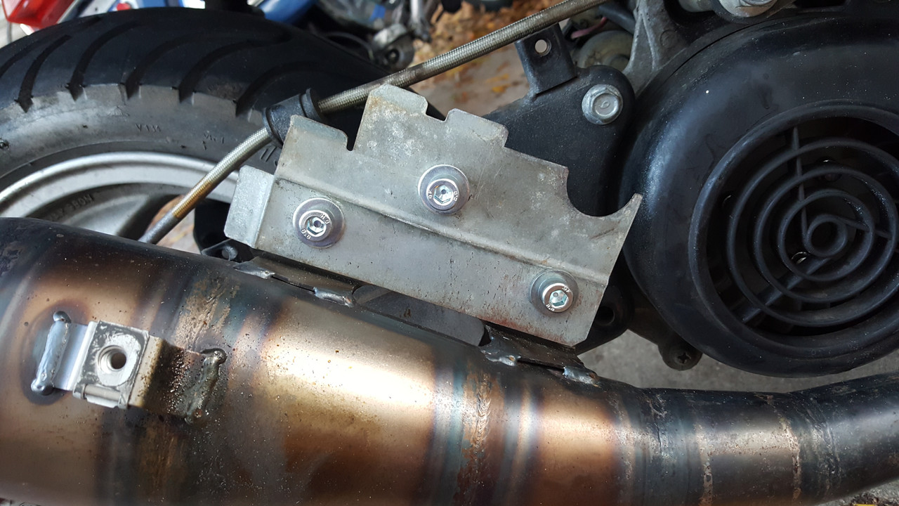

So I haven't had a real exhaust bracket on yet, I was using my old rear fender bracket and a zip tie and it allowed the exhaust to bounce around a bit which in turn loosened the mounting nut and bolt creating a crazy vibration. Last night I found a lil flat piece of metal from a RV refrigerator and drilled 3 holes in it... The chamber is so much more stable, and more solid feeling. I was thinking I'd need a thicker piece, but actually this works fine. Now I'll just cut it down to look better and paint it blue or something. Good spot for a 49ccscoot sticker... Side note: after all the tuning I've done, no matter where I put the CVT setup at my max speed is 56mph tucked. She rips off the line really good, flows with traffic effortlessly, such a fun lil scoot!
