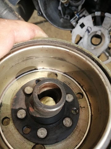

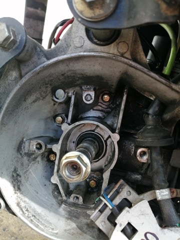

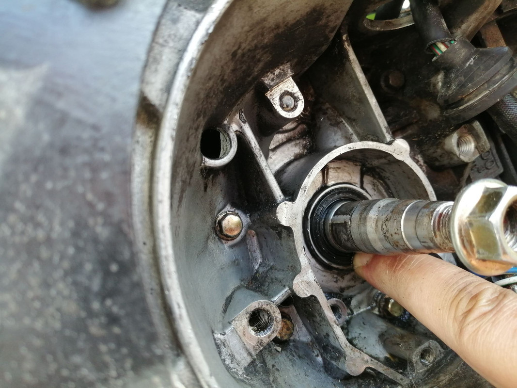

i have been getting sick to death the last 2 weeks as sometimes my jetting seems great and other times it seemed well off and not building rpm up passed 7k so made a pressure test kit and what do you know one crankshaft seal had gone and when i was stripping it down to find a stater plate bolt had broken off to and flywheel had been rubbing on the stater coils so going down today to pickup a set of stage 6 bearings and seals then just got to work out how to get that broken bolt out

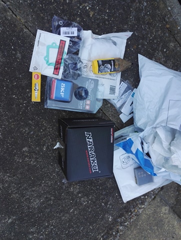

right been a busy day today and lots of parcels did not get a photo of everything but here is whats bits come today naraku 70cc cylinder kit aerox oem reedblock and reeds , aerox oem inlet aerox oem airbox stage 6 crankshaft bearing and seals tnt Full circle racing crankshaft naraku variator 4gm rollers 4.5gm rollers , 5gm rollers scooter gearbox oil 2 sets of gasket kits and waiting on a tecnigas q-tre exhaust engine is fully build and back in the bike just waiting on the exhaust then time for jetting

Post by mrchilled85 on Jun 3, 2020 11:21:18 GMT -5
Post by Zino on Jun 3, 2020 21:37:51 GMT -5
I went to studs after the second time I broke a exhaust bolt off .
I had to use a extractor to get a frozen bolt off when I was changing out a seal behind the stator . The first time I sheared a bolt I showed my wife and said I will have to order a new 70cc cylinder instead of extracting it . Its kinda a long the same line of why she has so many shoes and still buys more .
Post by mrchilled85 on Jun 4, 2020 4:34:19 GMT -5

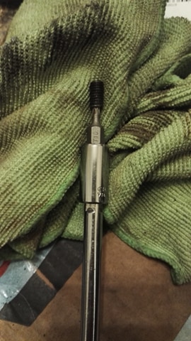

I went to studs after the second time I broke a exhaust bolt off . I had to use a extractor to get a frozen bolt off when I was changing out a seal behind the stator . The first time I sheared a bolt I showed my wife and said I will have to order a new 70cc cylinder instead of extracting it . Its kinda a long the same line of why she has so many shoes and still buys more . i would order a new kit but wife is not having any of it and she looked up on youtube and seen it can be drilled and tapped if needed im going into town today to see if any where is open that has drills in stock and get one + some 2mm drill bits and tap set
Post by Zino on Jun 4, 2020 7:46:45 GMT -5
My wife knew I was stretching the truth . I was just looking for a reason to swap cylinders . Its hard to keep these 50 cc for long once you have had that bbk smile .
Post by mrchilled85 on Jun 4, 2020 10:14:51 GMT -5
My wife knew I was stretching the truth . I was just looking for a reason to swap cylinders . Its hard to keep these 50 cc for long once you have had that bbk smile . dont i know it i was not going to put the stock 50 kit back on i have fixed it tho now i spent £2 on hss point 2mm drill bit and £10 on a old used drill off the facebook market place but look its nice out and did not do any damage to the thread as just tested it with a new bolt i drilled maybe 5mm down with the 2mm drill bit then tapped a small torx bit in and undone her with a screwdriver for my torx set im happy how she come out maybe 5mins work and nice clean finish in my eyes

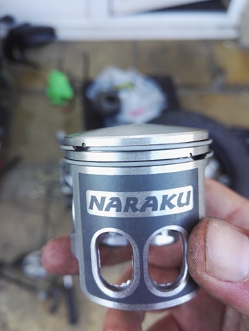

had to pull the topend off today as bottom gasket was leaking a bit so fitted a new topend gasket set and think i still need to down jet more as this is with a 82 main jet at sea level
Post by mrchilled85 on Jun 8, 2020 15:57:25 GMT -5

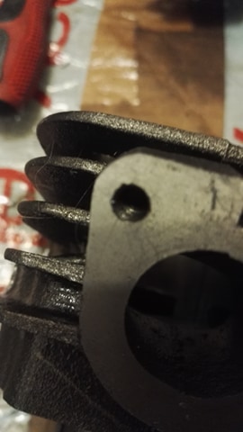

was going out for a ride tonight and as soon as i left something was not feeling right as down on all power and a lot more smoke then i was getting today + i had down jetted more to a 78 main jet over the 82
with in 2mins of riding i turned around to come home to find i had blown the spark plug thread out and was just pushing all the air out of there
lucky i have a spare 50cc head so fitting that in the morning but not the best week for the bike at all
