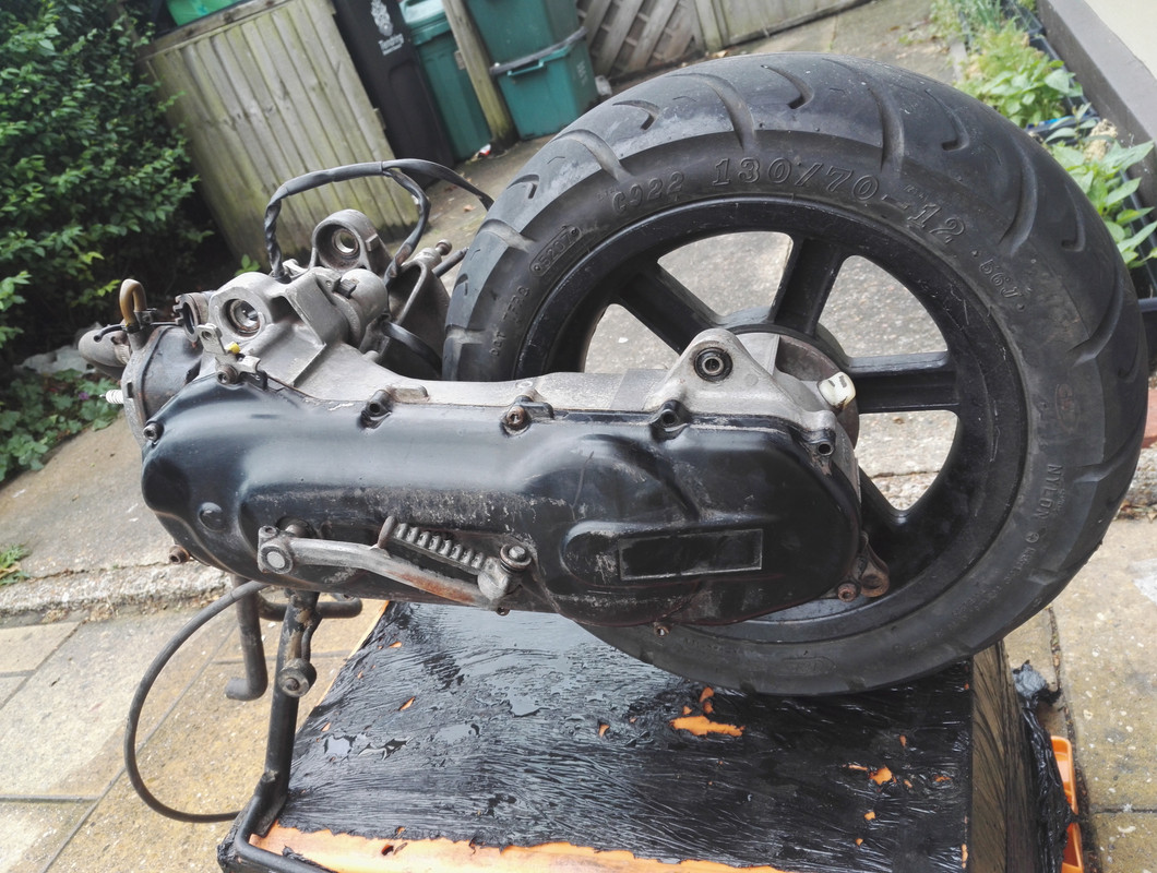

Post by mrchilled85 on Jun 29, 2020 13:13:39 GMT -5
done some porting work on the naraku 70cc kit last night and on the way home tonight from work the tnt full circle crankshaft broke the rod and no more engine case and naraku cylinder :/ did push it to 11,500-12,000rpm be for it let go the tnt crankshaft is only rated for low reving sports kit so thats why its let go im sure now im on the hunt for a aerox / jog lc engine for the bike

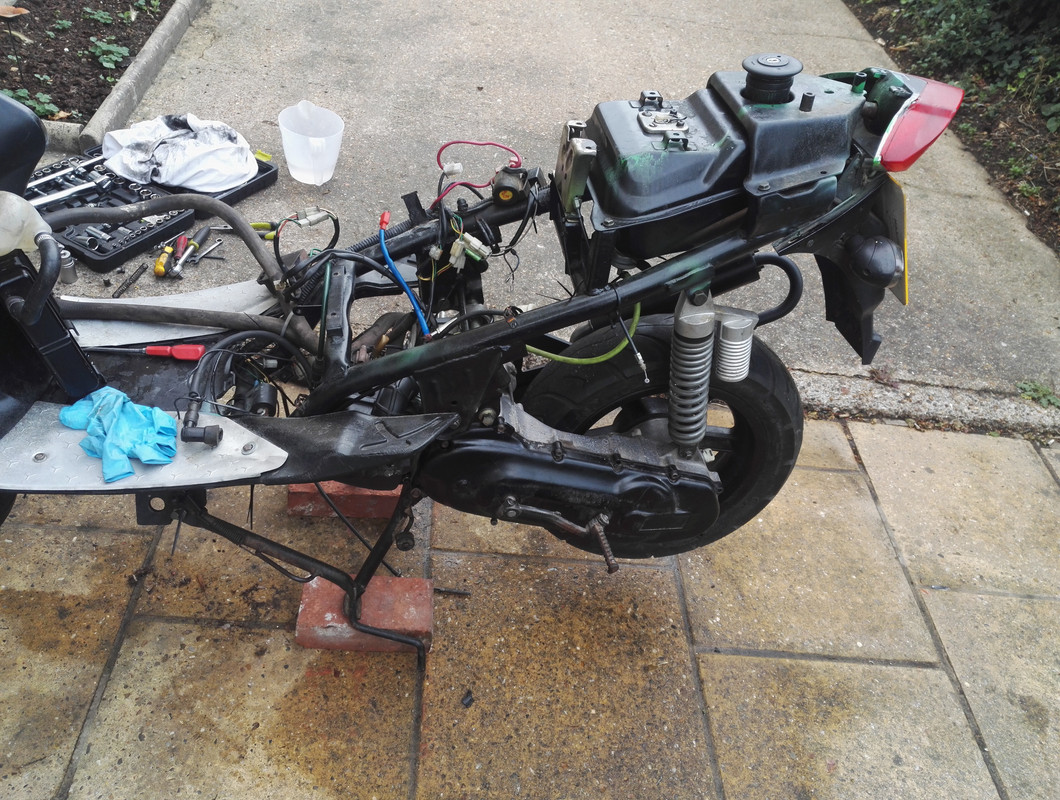

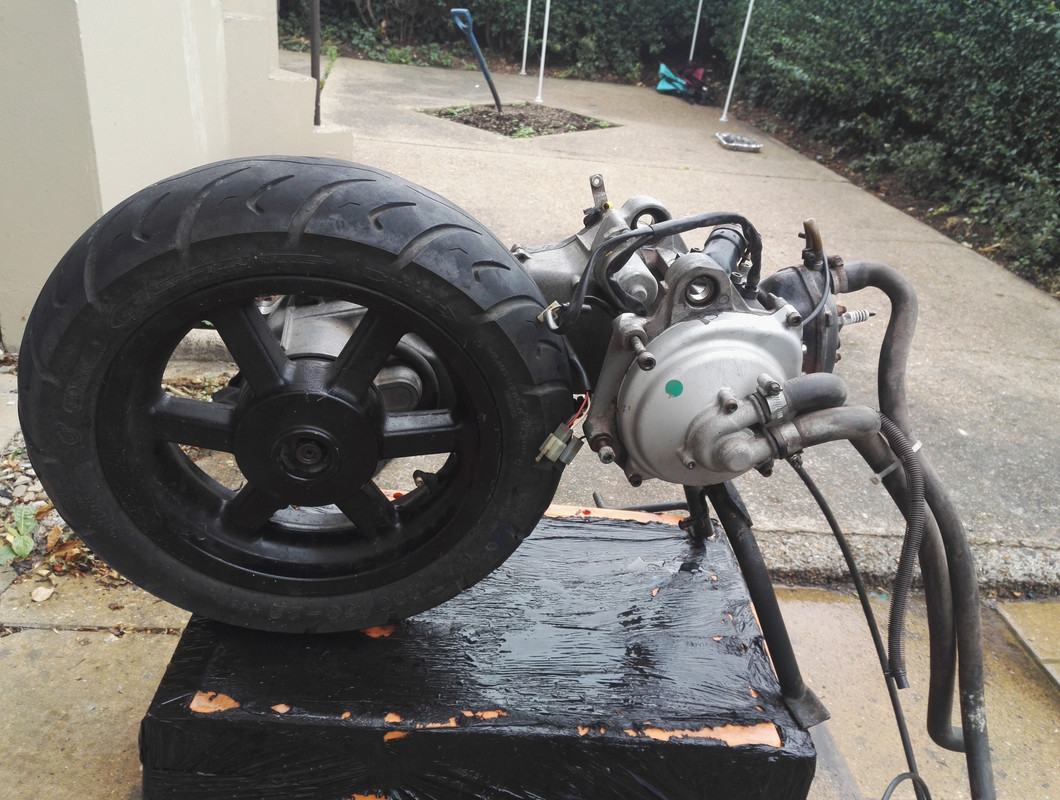

Post by mrchilled85 on Jul 8, 2020 12:32:20 GMT -5
the MALAGUTI f15 engine turned up today so cleaned it all down and got around to fitting it still need to mount the aerox radiator but this was just for testing to make sure it dont over heat and to make sure it runs and after getting the fuel back to the carb it starts 1st kick and ended up running it for 15mins checking for over heating and water leaks i did see a small leak from top head gasket but apart from that stayed nice and cool + was pumping water well checked over the cvt and fitted some 3.5gm rollers 1500 rpm clutch springs tecnigas q-tre exhaust motorforce kevlar belt 16.5mm x 8mm x 750mm went up the road 2 times and seems to go all right
