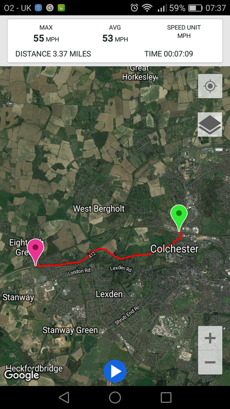

Post by mrchilled85 on Oct 19, 2020 1:52:58 GMT -5
not been on much for ages now due to a 2 week stay in hospital then having to isolation after coming home i got out on the bike with the built 103cc engine £120 budget engine i was not planing a high speed run as still running in as only done 35 miles so far but had a bit of a play not to bad for a 45mm stroker crankshaft $21 off aliexpress and 54mm bore kit off ebay for $50 , 21mm flatside carb $25 off amazon and used 14/41-52 jasil secondary gear up kit $20 and used tecnigas q-tre exhaust $15
Post by aeroxbud on Oct 19, 2020 4:09:26 GMT -5
That's bargain performance. 👍
Post by mrchilled85 on Oct 19, 2020 4:59:51 GMT -5
That's bargain performance. 👍 yep still had a bit more to go as well but exhaust is holding it back a fair bit due to being a 50cc exhaust and im running very rich to the stage of its a smoke machine when i open it up and its 30/1 mix thats been sitting in the tank for 4 months now but got a nice fresh tank of 45/1 mix still smoking a fair bit tho so will play with jetting and clutch springs over the next week as running a stock 1e40qmb clutch and springs and stock 90cc variator
