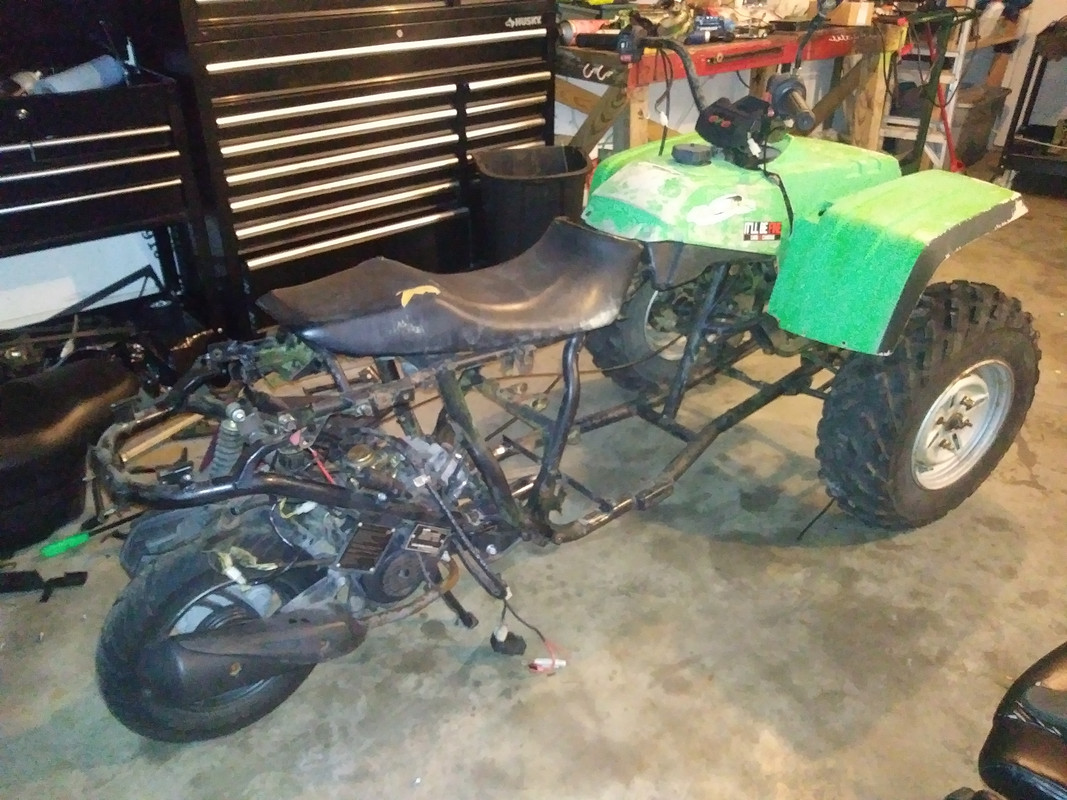

Thanks for the info, I had not removed the cover yet so I didn't consider that the fins would be much smaller than on most air cooled bikes. I had figured the cover was because of all the body work would block the normal airflow. I should have the BBK just after xmass, so hopefully will have time to install. I have another scooter based project I'm also working on:
