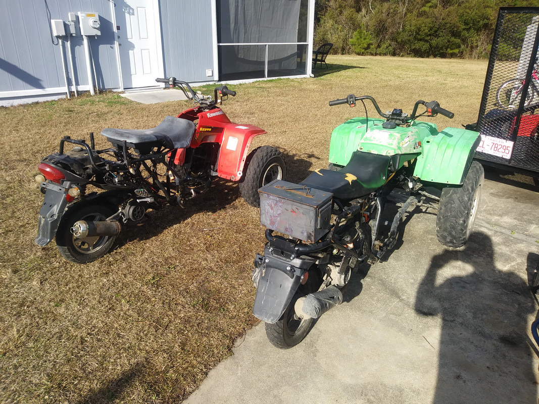

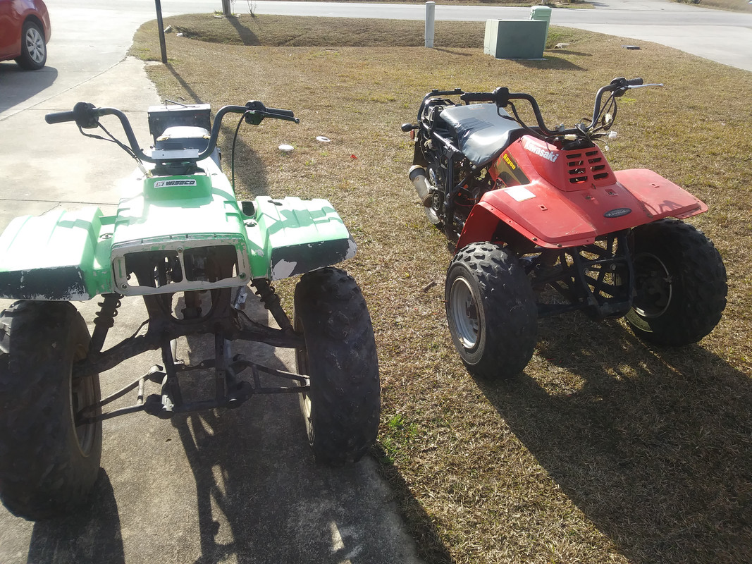

Thing One and Thing Two are basically done, both running/driving. I did put the new sliders into the green one, and this raised rpms's and gained a smidge of acceleration. But with the cover off I noticed that the belt was riding low on the clutch pulley. I happen to have a spare tao tao belt and threw it on and it rides much closer to the top of the pulley...so someone may have put the wrong belt on at some point...either that or the belt was just that worn down. I still want more bottom end power...I thought I had some 1500 rpm springs on hand but looks like I will have to buy some. I still have wire management to do on the red one, and once a new battery arrives I will add a battery box. Anyway, here are the machines in question:

Post by benhonda on Jan 28, 2020 17:31:35 GMT -5
I see...a CR500 in your future, with a fatty rear. Not unless I find one for around $50. I built both of those rigs for about $150 each. Getting any kind of engine with some real power could easily cost more than what I spent to build these. Plus, if these had a powerful engine, the rest of the frame would be a problem. My welding skills and the old frames/tires I have used aren't a problem since they can only go 30mph. Add speed, and you would have to install new bushings and bearings into those old atv frames as well as put newer tires on them.
But I am keeping my eye out for a 150cc scooter. I did have one I bought 2+ years ago for cheap. It certainly had speed and power that would be better suited for an ATV trike conversion. There just aren't a lot of 150cc scooters around here.
And I have a 80cc BBK that I think will be going on the green trike.
