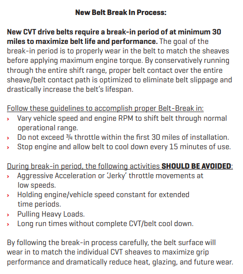

You will usually find a small reduction in top speed after fitting a new belt. They take a little while to bed in. The rollers sound too heavy. It's always best to weigh them. Even quarter of a gram can make a difference. Small pocket scales are cheap to buy. An essential tool for tuning your rollers.

ok thank you for your response, roughly how long do the belts take to wear in? and what size rollers would you recommend?
