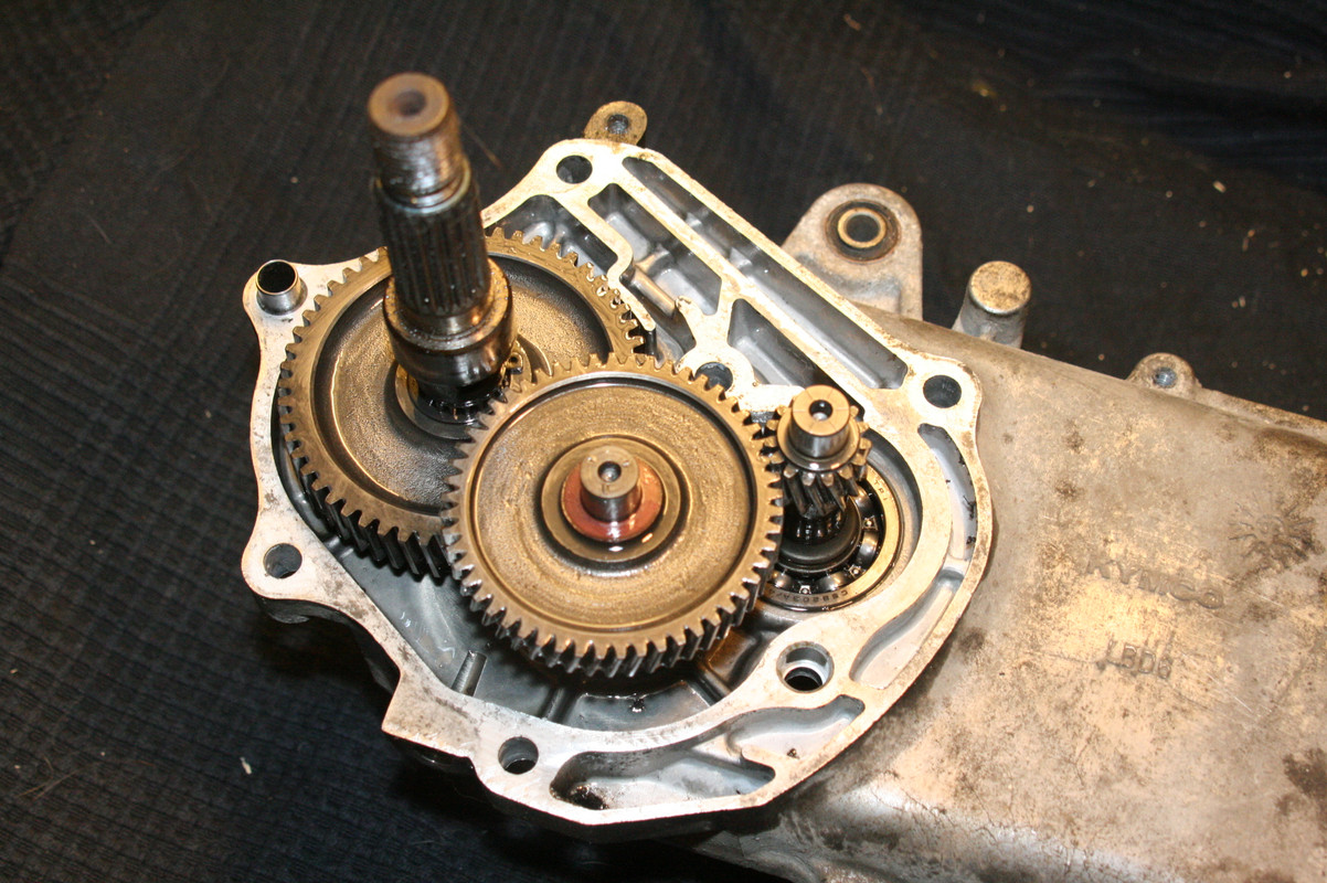

I found these numbers in the manual, not sure what to make of them tho.. Primary reduction : 3,25 secondary reduction : 3,4 hope it can help, I would really like to find out what the stock gear ratio is, before buying a new set. Also here is a picture, maybe it can tell you something.

Post by Zino on Mar 6, 2020 9:23:04 GMT -5
3.5 x 3.4 =11.05 if yo go to dexes gears 2.63 x 3.4 = 8.942 Here are some gear ratios Kymmco run better ger ratios stock then alot of scoots . 49ccscoot.proboards.com/thread/1265
Post by dexameth on Mar 6, 2020 9:41:43 GMT -5
Most of the time the stock secondary gears are 52/15 if I remember correctly (those are the ones most people change)
