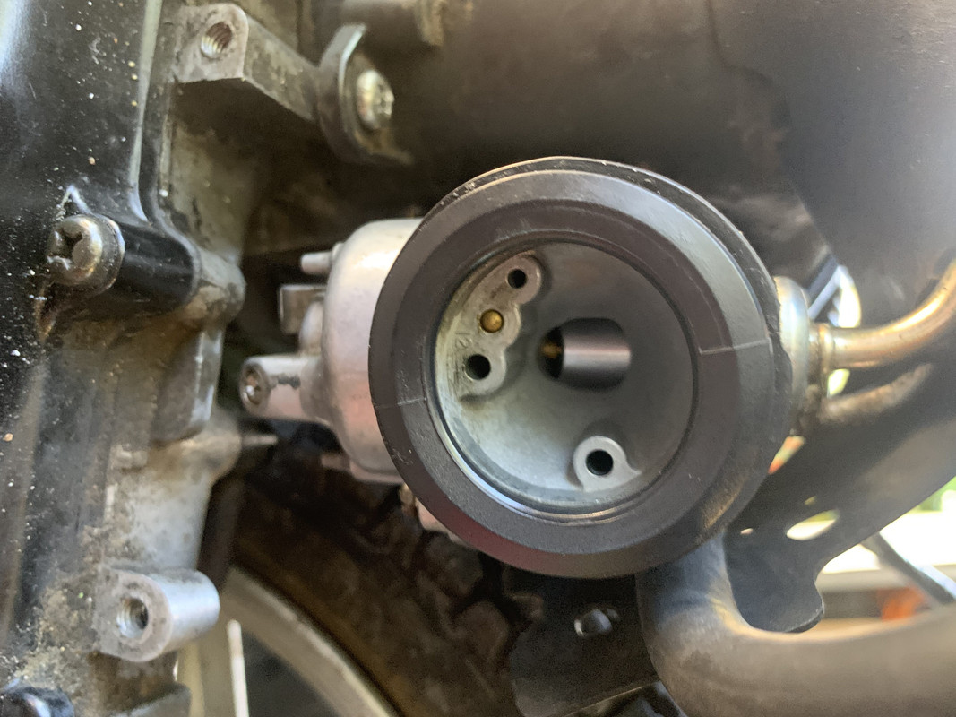

Have you got this to start yet,carbs don't "wear out" there are only a few moving parts post a few pictures of your carb.
Post by NathanielS on Jul 27, 2022 11:07:33 GMT -5
No, I have not gotten it to start... it must be clogged up somewhere. do you want pics of the inside, outside, or both? Here's some pictures of the outside, if that helps any: these pictures were taken after I cleaned the carb
Post by NathanielS on Jul 27, 2022 11:11:28 GMT -5
I did disassemble the carburetor and soak it in a bit of xylol. after that, I scrubbed off buildup with a toothbrush, and sprayed carb cleaner into areas that I couldn't get at. There was a lot of gunk in it, because the liquid (now xylol mixed with carb cleaner) was yellow! (It was clear before)
Post by geoffh on Jul 27, 2022 14:37:29 GMT -5
It looks like a "normal" dellorto style carb would replace that should be $30 ish,that's a vertical style engine,they can collect debris and old petrol in the bottom of the crankcase that needs clearing out using flexy pipe to widdle in there and syphon it out check its clear,clean the carb passages with electrical wire,keep at it.
