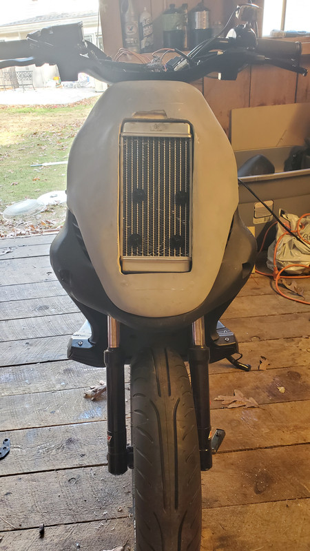

THE DAY HAS COME! I finally mounted the unfinished radiator cowling today with all the fixins'. Pump, hoses, Spall Puller Fan, lights, lighting relay, pump and fan controlls, finished wiring harness and custom pipe bracket. She started right up first kick. I decided enough was enough and this bad boy was hitting the road TODAY at any cost. Turns out all it cost me was my secondary shop fan that fell on my head while I was in my stool. I lost her to an angry javelin toss across the yard. My initial plan with a whole bunch of funky radiator hoses and S bends was just not fitting right. I ended up swapping one of the 90° heater hose fittings for a straight fitting of the same size. It allowed just enough clearance to fit the radiator no problem. I also cut the hole in the cowl for the radiator fill cap. It can only be removed with the headset turned all the way to the right but thats fine with me. It doesn't rub or interfere with any of the plastics. I need to get acoolant expansion tank to catch any overflow coolant. After a bunch of fuss with the radiator fan and the temperature switch just not working I opted to use a fan controlled by a switch. I wired it up right next to the pump switch. With the fan and pump running I still have just enough voltage for charging at idle which I am very pleased with. The scoot is clearly not tuned right. The 100 main jet didn't feel snappy and the CHT went up to 280° at one point. Way too hot for a LC build, even a shotty one like mine . I swapped in a 113 main jet and now I am bogging at WOT. I'm thinking ill end up at around a 108 mainjet and the needle clip smack dab in the middle. I rode it (without plates ) around the neighborhood and it felt OK. Clearly needs to be dialed in. However it does sound like a small MX bike and thats tight as hell. I added a photo of the cowling.

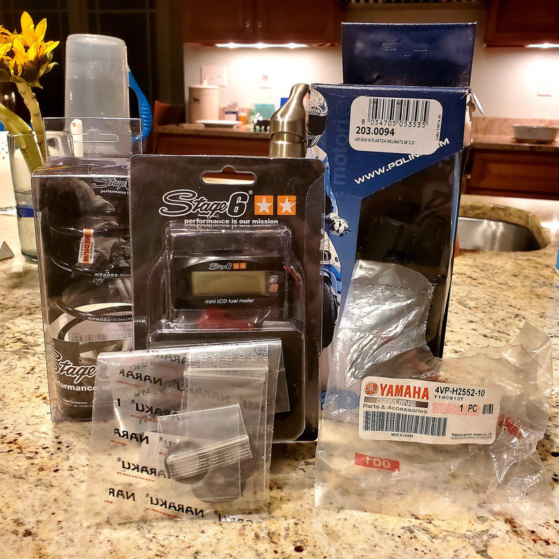

A package arrived from Canada today and that can only mean one thing, scooter parts! I ordered up a medium torque spring from Stage6, a Stage6 mini fuel gauge, a Polini 90° air filter, some variator spacers and a ignition cover for a Zuma. Couldn't find a PGO one without buying a whole new lock cylinder so this works fine. I'm really excited for this fuel gauge. I know I don't necessarily need one but I really like the convenience factor. I'll post a short video about the install. I couldn't find a good one in English on YouTube.

Here's the installation video

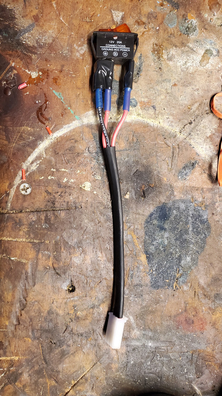

I've been trying to cleanup the wiring and get organized. I've been swapping all the spade connectors with automotive disconnects wherever I can. I made the little plug and harness for the water pump & fan switch today. A word about PGO and liquid cooled builds. Just don't do it. Im about at my wits end with this damn PGO scooter and motor. Its not a bad platform at all and things are well made but parts are a huge pain in the ass. Things will be listed as fitting and won't. Things that aren't even listed for the PGO motor or scooter will work just fine. Seemingly nobody knows what's going on in terms of aftermarket parts. Go get a Yamaha Jog/Zuma clone or Honda clone and be done with it. Just mounting this exhaust that is listed as being functional and fitting has taken weeks. I've had to tech myself CAD, basic welding and purchased all sorts of tools I dont need just to get the pipe to sort of fit correctly. If you go PGO avoid anything that isn't strictly listed for the scooter and other people have used it. As for liquid cooled swaps do not do what I am doing with this custom panel. Its such a colossal pain in the rear im close to scrapping the whole thing and just going air-cooled. Absolutely nothing works the way it was intended. The radiator cowl doesn't fit. Hoses constantly leak. The pump gets too close to the pipe and the bottom half of it melts out. Its just not worth the extra hassle. If I could go back I would have avoided all of this nonsense and just mounted the radiator inside the kick panel like everybody else. Way easier to install and finish. Better yet I would have never gone LC at all and went right back to air cooled aluminum cylinders and never looked back. Right now the current plan is to finish the build and sell this thing cheap to get a Yamaha Jog and do a 90cc swap into that. Im not even interested in riding the Roughhouse at this point. With 25 years of parts development and thousands upon thousands of builds in the Jog you just can't go wrong. There's a 90cc 1996 Jog from the Dominican Republic near me for $1500. Ill just buy that and sunset this damn Roughhouse as quickly as I can Im at that last 10% of the build that takes 90% of the effort and time. Boy am I tired of looking at this thing. My understanding of the Genuine Roughhouse and the Genuine Buddy is that it uses Minarelli bores with a honda type transmission components. This is just the conclusion i came to from researching modified parts for the Roughhouse/Buddy platform.
