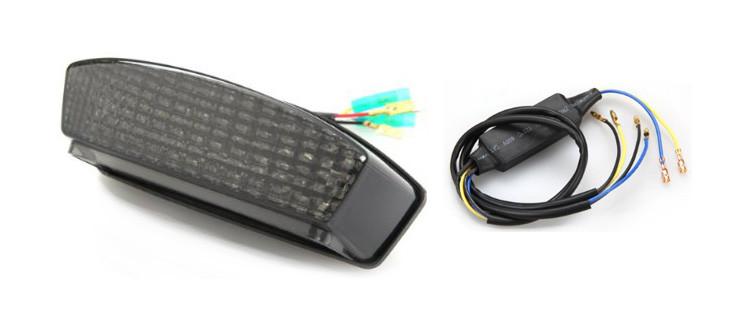

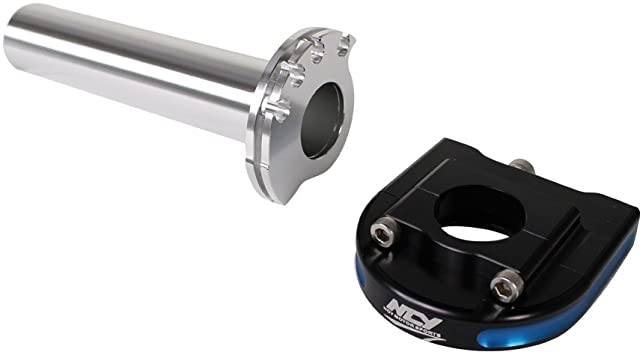

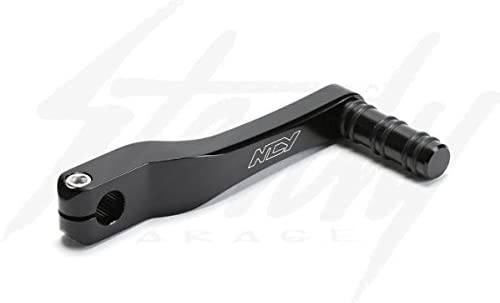

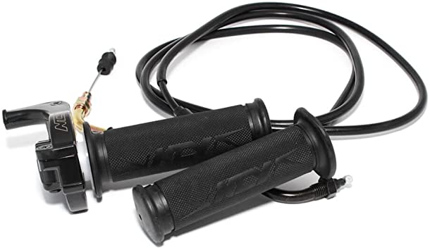

I ordered up some parts from NCY, only quality of life stuff really. I ordered up a NCY kicker because I hate the original one. Here it is. I also ordered up an NCY quick-throw throttle. The first one I ordered is a dirt-bike style with a PWK cable. I shaved down the carb end of the cable to work with the OKO style cables aftermarket carbs use. Unfortunately the cable output contacts the brake master cylinder so I cant use it. If anybody wants a cheap aftermarket quick-throttle ive got one for ya I ordered up the other style of quick throttle with the smaller case so it wouldnt contact the master cylinder. This is the old one this is the one that will fit. I also had to order a longer OKO style cable to work with the new Delloto PHGB and the new throttle. Ill post up some images when they are installed. I also found a great replacement for the stock tail light and turn signals which are terribly ugly. A Ducati Monster integrated tail light is an exact replacement for the Genuine Rooughhouse tail light but is smoke black and has amber turn signals within the light. I ordered one up from Ebay for $25, ill report back on how it looks on the bike. Lastly I need to figure out how to hide all the wires on the bars of the scooter. Right now it looks like a total rats nest and really ruins the look. Any ideas on what I should do?

Got some odds and ends tied up this afternoon. I made a bracket for my TrailTech TTO Tempmeter that mounts into a previous rear view mirror bolt hole. I also mounted up the NCY throttle and kicklever. Both seem quite nice, I am excited to use them. I am planning to repaint or re-coat the side cover for the CVT. Theres a local powdercoating place who could blast it and paint it a nice flat black or gunmetal grey.

I got the new integrated LED tail light in today. It didnt take long to install onto the scooter. Unsurprisingly the Ebay unit did not come with a wiring diagram so that made things a little harder. I put up a short YouTube video about it and included some instructions in the description. I found a great wiring diagram (in color!) somewhere online and cant remember where I found it. Ill attach it here so anybody following along also has access to it. It was a great help.

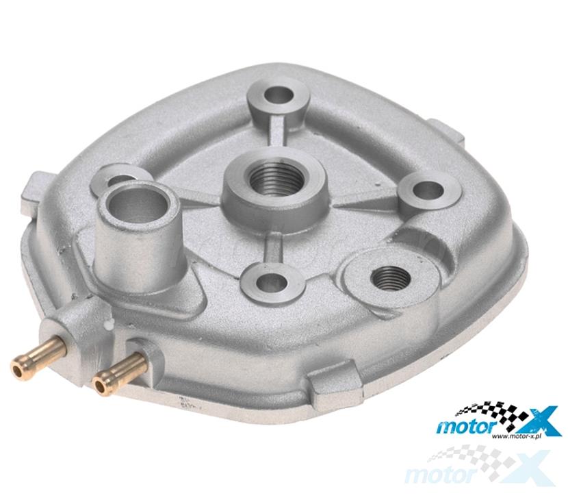

This may be a silly question for yall, but I installed the Corsa this afternoon and I can't wrap my head around those two brass nipples on the head. What are they for? What do they do?
Post by oldgeek on Aug 4, 2020 21:59:21 GMT -5
Some Carbs have a water loop for lack of better terminology. Maybe that's what they are for.
Post by Lucass2T on Aug 5, 2020 5:45:29 GMT -5
Yes, it's indeed for the carb heating function. Just loop it, just like on he carb itself. Unless you live in a cold climate.
