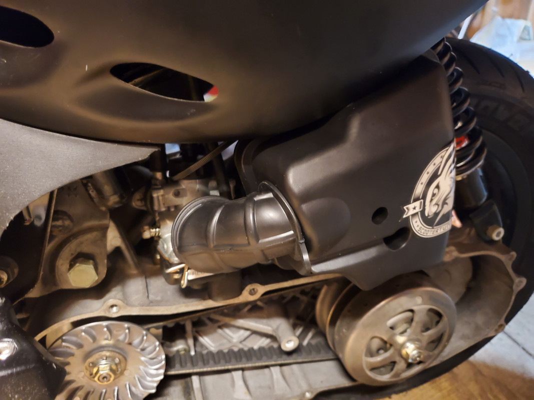

I painted and glossed the CVT cover tonight. Tomorrow ill be doing the paint correction to make her pop. I managed to shoehorn a Yamaha 3KJ airbox into my scooter. I am not sure how but hey it barely fits. Im worried that with enough suspension travel it will get squashed between the motor and frame.
