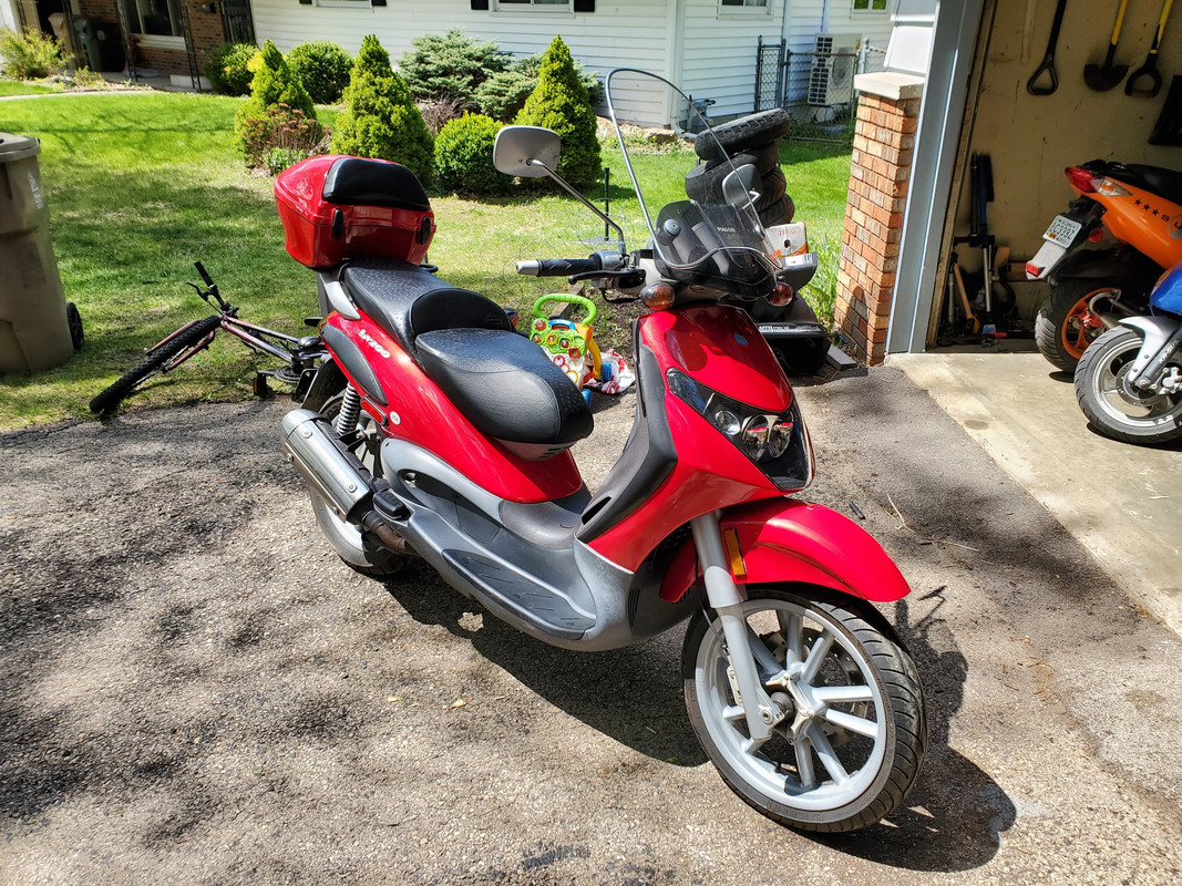

found a deal on a 2003 Piaggio BV200. went and got my motorcycle instruction permit at the DMV today. Now I have to get the thing to run.
It has some electrical issues. Been sitting for five years. Had some mice living in it. Mostly just thinking I'll post my updates as I troubleshoot this stuff unless there are some experts here.
It has an engine immobilizer system with special keys. Right now that's not working out right. I however did get it to turn over once, right after I put in a new fuse for one that was broken.
Some mice have chewed wires by the battery. Maybe they did elsewhere too.
From the service manual it's telling me to check the "immobilizer aerial", a ring around the ignition that transmits the codes of the keys f or verification. I'll check that next.
The manual says to not use non-original spark plugs because that can mess with the immobilizer system. (what??!) and guess what, it has an autolite plug in it (WHY OH WHY WOULD YOU DO THAT).
I'll put the NGK plug in tomorrow after I get one and see what happens with that immobilizer diagnostic code.

Post by wiscootsin on May 14, 2020 16:30:35 GMT -5
Took the front leg shield to check the status of the "immobilizer aerial."
Filled up a shopvac with mouse nest materials. And the wire on the immobilizer aerial was indeed chewed in two.
Cleaned it up and repaired that (and wrapped up another wire that was chewed). Then I started it...
"DAD MOUSE NESTS ARE COMING OUT!" what...
crud was coming out the cvt cover vent.
So had to take the whole side of the scooter apart to get the cover off. mice chewed the belt so i have to replace that. Jeez that's a pricey belt. Three separate mouse nests (so far).
I can't get the drive face off the driveshaft without either taking off part of the engine with the dipstick (which would let out all the oil) or potentially needing a castle tool to take the pieces apart to remove that half of the variator drive bit by bit. I'll check the service manual. Have some time to wait on parts now anyway.
