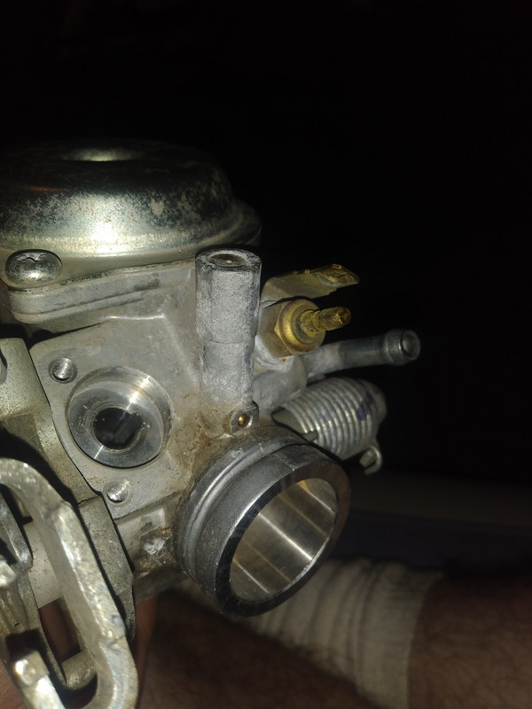

Post by CrankingWithCG on May 26, 2020 0:30:10 GMT -5
In an effort to get my 2007 vino running, i took off the botched Mikuni BS26, and am attempting to mount a spare 24mm cvk carb on it from a GY6 150 motor. The auto choke is deleted, and i have the vacuum lines hooked up, fuel line and all. Have it jetted for what i feel a 125cc gy6 would have with. On the mikuni, there are two wires that plug to the front of the carb. Do these wires need to be connected to anything, or will it start and run with the 24mm? The 24 doesnt have a place for these wires. Can it run without these wires, just unhooked? Pictured is the BS26 where the wires connect. I have no clue what they are
Post by sammyrocker5150 on Jun 5, 2020 9:35:40 GMT -5
Those are the positive and negative wires for the carburetor heater which i think is part of the autochoke you also no longer have.

Post by CrankingWithCG on Jun 7, 2020 18:11:53 GMT -5
Also you should post updates on this build! For sure man! Gonna post a whole thread about my custom 150 too. So it should run with the GY6 carb? I don't need those wires to hook together or bypass them or anything?
