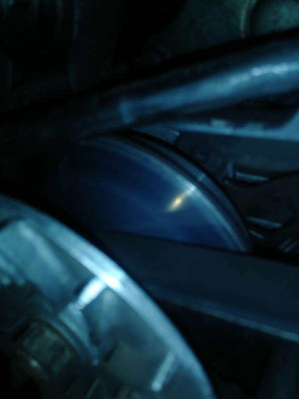

Post by CrankingWithCG on Jun 15, 2020 0:11:27 GMT -5
More power you usaually go down to have it shift at the same rpm . You now have more power to fling them out so you can be lighter. I prefer to go as light as I possibly can with the best top speed . Run your 12s run half and half like this 11,12,11,12,11,12 for balance and run all 11's See if you like all 11's best than buy some 10's and run them mixed with the 11's and all 10's If you take notes on each set up for top speed and how your Butt dyno likes the take off tak your favorite combo . Just looked at my variator, and it rides basically all the way up. Theres only maybe a mm of untouched surface. Same with the inside of the rear pulley. I think i could go a little lighter or a little heavier, i just don't wanna push for more rpms if its not gonna make more power up there and blow up ya know 😂 I think im gonna just try lightening the cvt set up. Im getting a 160 kit and probably porting the head, so i may just go up a gram or two just to be safe. But yeah, light ass polini clutch and a lighter bell i guess
Post by CrankingWithCG on Jun 15, 2020 0:26:00 GMT -5
There's even less untouched space in the back pulley, maybe half as much as the front
Post by Zino on Jun 15, 2020 0:58:43 GMT -5
The travel is good so if you like how she responds dont go lighter.
