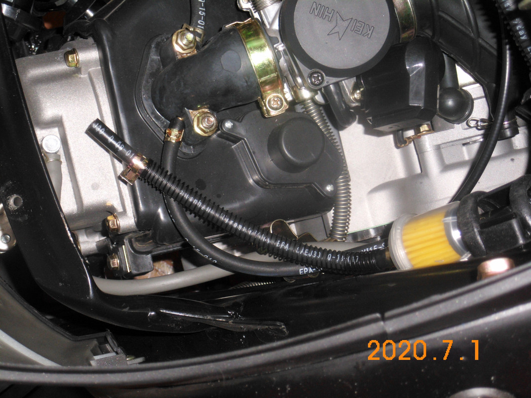

Oh for Pete's Sake! Even I can tell what the culprit is. The line (fuel) passes through the filter a ways and then just hangs. (I adjusted it for display) There is the clamp, at least that. Seems the filter has dislodged from the holding"cage", indicating the line was somehow pulled or dislodged either at factory or in transit. That be as it may, what remains is connecting the line to where it belongs, which means I again must call on your experience and generosity.
Post by FrankenMech on Jul 1, 2020 12:53:03 GMT -5
See that black lump on the side of the carb. That is the enrichment valve, an alternate 'choke' for cold starting. Right below and to the rear slightly is the fuel inlet nipple. Connect the fuel line there. They must have disconnected it to drain any fuel for shipment. Look up the manuals link and find a service manual for the engine. www.49ccscoot.com/manuals/manuals.html
