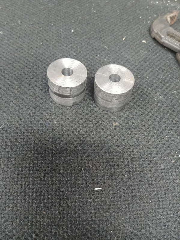

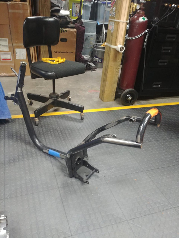

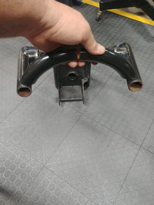

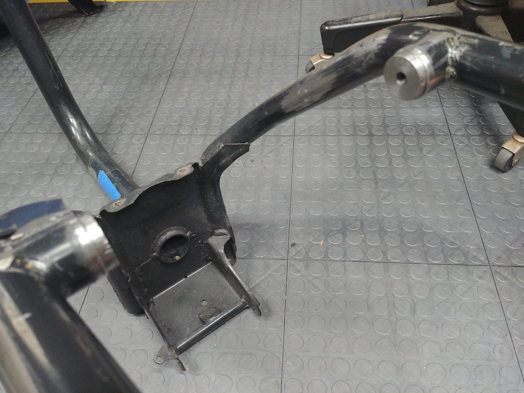

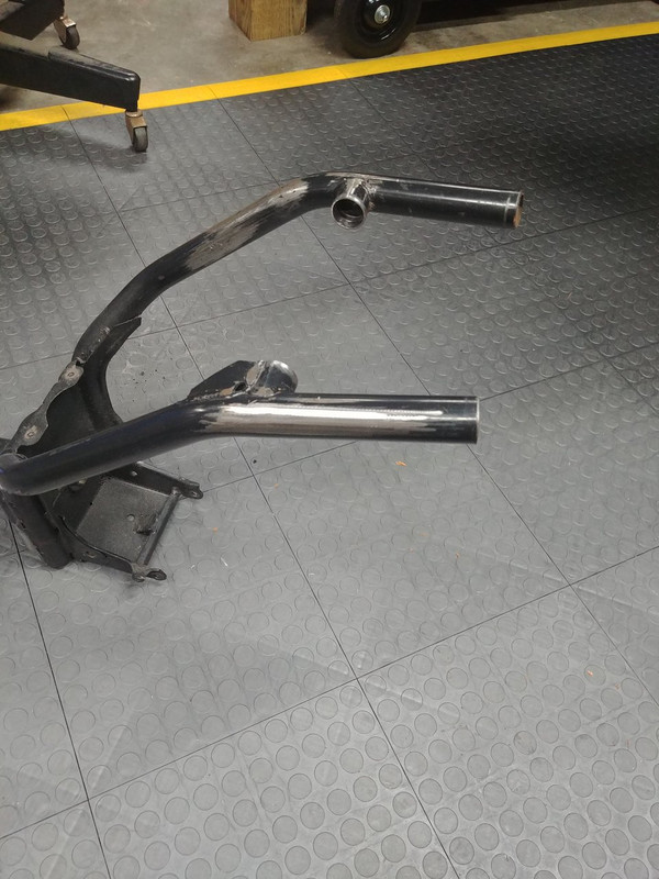

I went over to Lowes today to pick up a few things and finally remembered to take the upper shock bolt with me so I could figure out exactly what size it is. M10 x 1.25 I looked for a tap there but they only have M10 x 1.5 I ordered a 10 x 1.25 from the Amazon, it should be here Wednesday. I also found out what drill to use for the tap, 11/32" I used my M8.5 drill bit and it came out to 8.65mm so that is close enough.  A final test fit of the plugs in the frame looks good. I am going to cut the threads in them before I weld them in place.  I also decided to cut more of the frame off, It was going to have to come off anyway to make more room for the pipe.   Here are some of the ways I could tie the two sides of the frame back together.    I could even do it like this and use the seat pan to tie them together. Whatever I do I want it to be strong and tie the two sides back together solidly.  I think if I do something like the picture above, I would need to shorten the frame up some more before welding the pieces that turn up back on. A couple more bracket designs are in my brain, somewhere? At least I am moving forward.

Post by hippo008 on Oct 27, 2020 12:27:13 GMT -5
I like the first mount. Easier to build and weld. That will be plenty strong and make the rear exit pipe look sharp.
