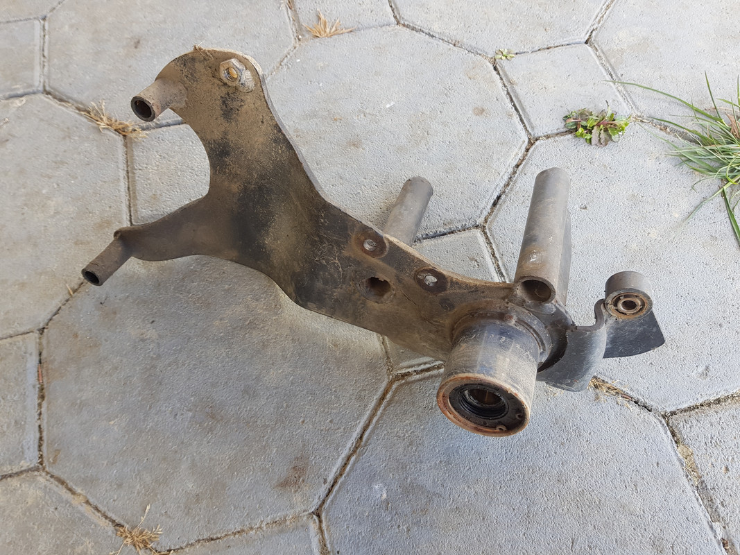

Post by KSR Moto on Jul 18, 2020 4:42:46 GMT -5
Does anyone know which size bearings go into this?
Post by Mech Warrior on Jul 18, 2020 12:29:24 GMT -5
You can measure the dimensions of a bearing by using a vernier caliper like the one below or measuring accurately with a ruler. All bearings will have an inner diameter (ID), an outside diameter (OD) and width (W). Bearings are sometimes referenced by these dimensions, in that order: ID x OD x W.
Post by Mech Warrior on Jul 18, 2020 12:31:08 GMT -5
You can also enter the year,make and model of your'e scoot and search for parts diagram and you may be able to order a exact replacement bearing.
Post by snaker on Jul 18, 2020 14:40:02 GMT -5
What's is say on the side of the bad bearing?
Post by rocketdogiv on Jul 21, 2020 19:20:50 GMT -5
Read the numbers on the bearings and seals. That will tell you the size, they are international. I have one of those in my garage I'll look.
