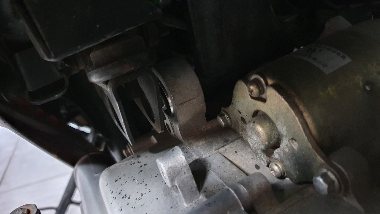

Post by KSR Moto on Jul 21, 2020 3:27:54 GMT -5
I have just replaced my worn out bushings with new ones and after bit of riding I noticed that they are not flush with the case anymore Why is this happening?
Post by FrankenMech on Jul 21, 2020 7:06:41 GMT -5
Bushing housings are worn letting the bushing slip. Push them back out then back in with Green Loctite bearing retainer or green Loctite penetrating threadlock.
Post by KSR Moto on Jul 22, 2020 8:43:27 GMT -5
Great idea,what about putting some loctite on and then adding a washer slightly bigger than the bushing to both sides to help keep it in place
Post by FrankenMech on Jul 22, 2020 9:51:24 GMT -5
The washers would transmit vibrations and probably would not help keep the bushings in place.
