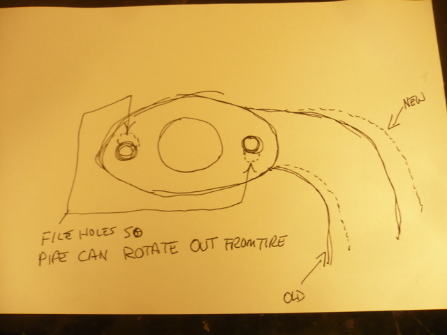

Need to file the front hole and use some flat washers to help clamping,kinda like this;

i'm such a dip, I was thinking I was gonna have to bend it or have my uncle reweld it. I'll bring my rotary tool home from work tomorrow. And hopefully be zipping around smiling ear to ear this weekend. I think the exhaust not lining up was the cause for it bogging above 3/4 throttle before. Came across a post on mopedarmy.com about putting rubber hose in between cooling fins to see if they're the cause of my rattle. Apparently polini(and some other manufacturers') cooling fins can pick up engine resonance and rattle. Figure what do I have to lose. Otherwise squish is at 0.7mm now thought I would've gotten more out of the 2nd base gasket. I'll likely pull it apart again since the edge of the piston is still slightly above the bottom of the exhaust port. I won't have my squish adjustment kit until monday anyway, so if I can get a couple days to ride this thing i'm gonna take full advantage of it.

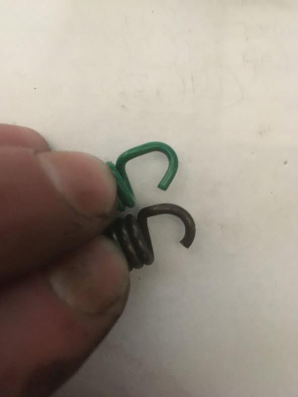

So finally got around to installing the stiffer clutch springs(blue), was a royal PITA until I realized the malossi springs had a tighter curve on the ends compared to the stock springs. Once I flattened one side out on each spring was a lot easier. Think i'm gonna try the reds which are the stiffest in the kit I have, and see how they perform. Funny that i'm still running a tad rich and bogging at WOT w/ a 85MJ and the e-clip in the highest needle notch. My highest temp so far has been 286*F think i'll throw the stock 80MJ back in and needle at lowest notch.
