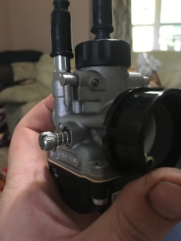

Well couldn't stop at just a crank and bearings. Ended up ordering. Polini Corsa Yasuni R Polini For Race Crank Delorto PHBG 21mm Stage6 Intake/ Reed Cage 2 sets of Crank Bearings/ Seals Tusk Case Splitter/ Crank Installer I think I have a problem. I like the part list you got the Need for Speed .

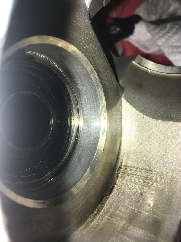

Post by Zino on Sept 22, 2020 7:33:45 GMT -5
Must have been made on Friday after a Italian Holiday. They should swap you out for a different cylinder or they could clean this one up for you with there porting service.

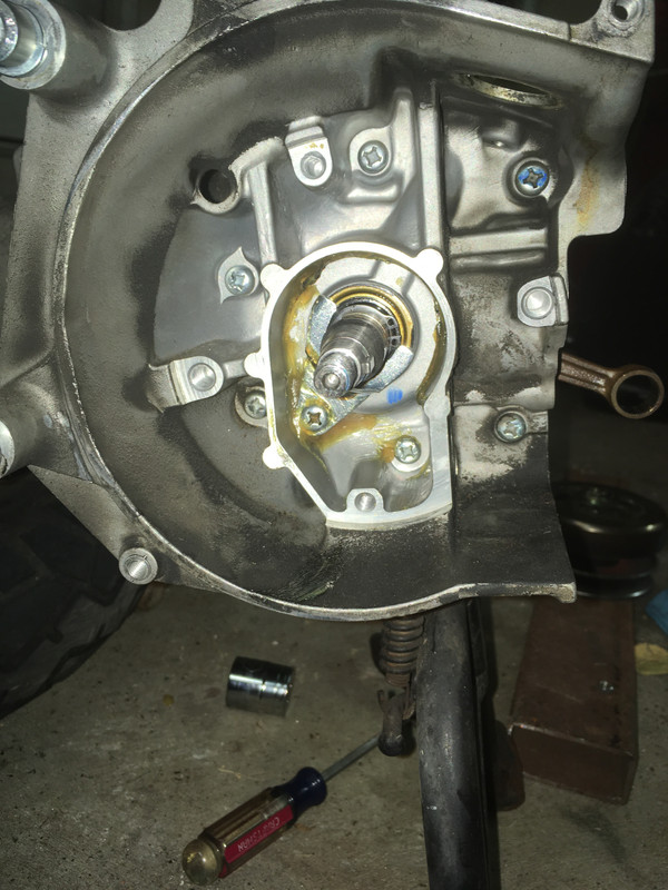

So much better in the Yamaha engines where the use bolts. I have used a big flat screwdriver to get springs off before. Or even a couple of zip ties. Hate removing centre stand springs though. Oh yeah the Philips will be replaced w/ Allens like w/ the CVT cover. Glad they decided to use hex heads for the transmission. I cheated and just removed the pin first made getting the spring off real easy. Wonder if I can cheat and use the same method putting it back together.

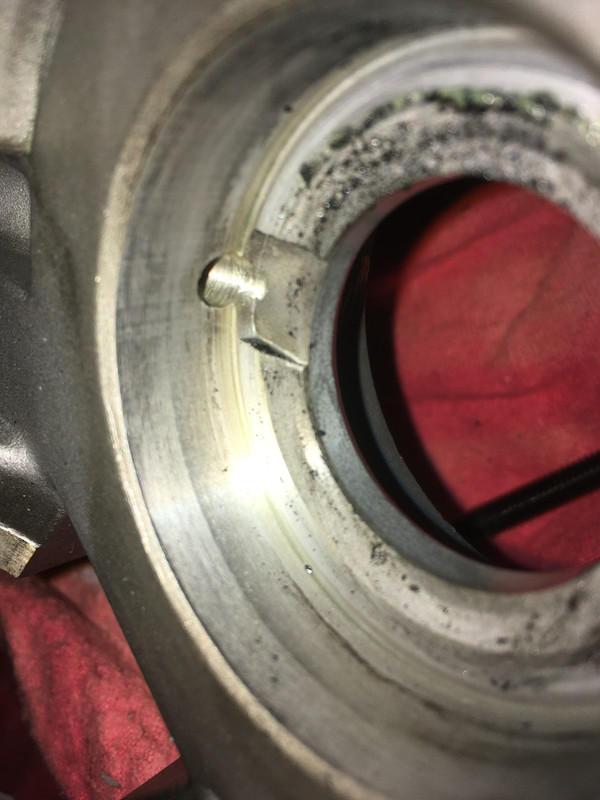

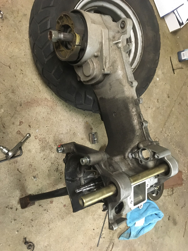

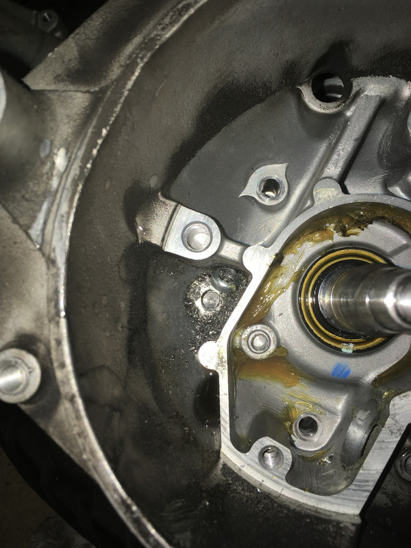

Using my impact philips set the rest of the case screws came out w/o issue. Had to take a drill to the one that cammed out, the head on it was fubared. Split the case. Stator side gave some resistance, but CVT side bearing came out easy... a little too easy. Think the bearing might've spun in the case. It slid half way out just by the weight of the crank then w/ just a smack of my hand came all the way out. CVT Side Stator Side Think i'll pick up a sacrificial crank bearing and see how much force it takes to press in.
Post by Zino on Sept 27, 2020 5:52:25 GMT -5
Looks good do you have a heat gun it will make dropping those bearings in so much easier .
