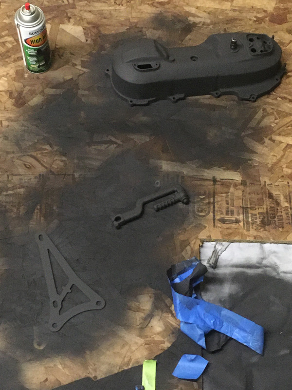

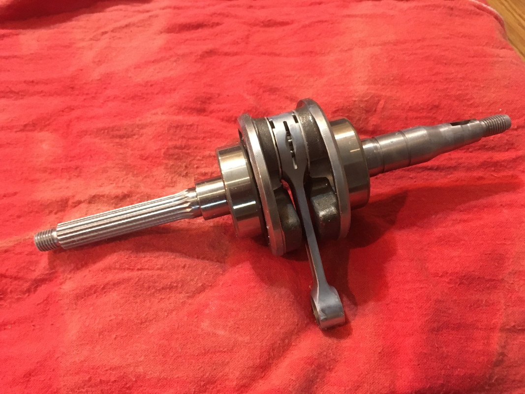

Got the case all painted.   Doing final touch ups on the CVT cover, exhaust bracket + hardware, and kickstart lever.  Also got the bearings on the crank.
Post by aeroxbud on Sept 29, 2020 4:29:34 GMT -5
Making good progress. It's funny, I always prefer putting the bearings in the case's first. No right way. But I wonder what a psychologist would make of our choices? 😂
