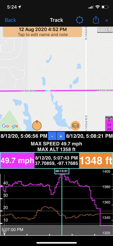

If you are at 340 ish on a 2 mile run I would leave jetting alone for now . If you are burying the the needle you are probably closer to 48-50 . You should check your cvt for travel with your vents . The stock motor port timing holds you back The exhaust port is half closed. When you get your kit on there paired with the Yasuni you will pick up a few hundred more rpms with power . So you will bury the needle easier . When you’re right you’re right. When the needle is pegged into the corner of the odometer is this picture. tuck down a hill.
Post by Zino on Aug 12, 2020 17:48:48 GMT -5
Now you see why Yasuni gets High Marks . High 40's with just a pipe .
Just think you are going to pick up another notch of power with the kit you got coming. It might only add a couple miles to the top end but you will bury the needle quicker.
