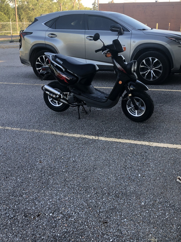

Post by jayrod427 on Aug 18, 2020 8:01:04 GMT -5
Wow what a difference new tires makes! Rides sooooo much smoother, handles much better with more confidence turning. Also painted the wheels metallic silver rattle can. Also took off the mud flap.
Post by aeroxbud on Aug 18, 2020 12:53:46 GMT -5
Those wheels really pop now. 👍 What tyres did you go for? They really can make a big difference.

Post by jayrod427 on Aug 18, 2020 13:11:39 GMT -5
Those wheels really pop now. 👍 What tyres did you go for? They really can make a big difference. Yessir I wanted to break up the all black party with some contrast, luggage rack matches as it will get repainted with same color to fix the wear and tear. Went with the Michelin boppers. I can't believe the ride quality improvement. Of course 11+ year old tires were a little brittle and stiff. LOL
Post by Steve B on Aug 18, 2020 15:18:33 GMT -5
I like the new sneakers Jayrod427.
Post by Zino on Aug 18, 2020 17:26:02 GMT -5
Nice looking wheels . Looks faster just sitting still.
