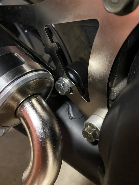

All of mine are close fitting. Had five Yasuni pipes. But none touched like that. The mounting that's touching is not right.The silver tube should not stick out Like that.

All of mine are close fitting. Had five Yasuni pipes. But none touched like that. The mounting that's touching is not right.The silver tube should not stick out Like that. It is just barely touching and if I removed the washer on the front under the bolt it would probably clear it but at this point I didn’t feel like taking it all apart just for that. If it really is not right then obviously I will take it apart and fix it though.

It's like the spacer isn't in all the way. Or tight enough. The rubber bushings should crush together. And the metal spacer shouldn't be visible.

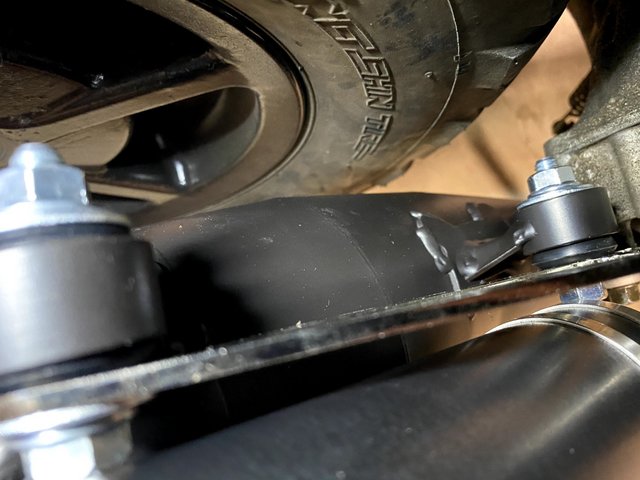

I took some closer photos that hopefully show it better. The rubber bushings are compressed pretty good. I used a washer on the front side as well as the back side of each bolt so there are 4 washers total on the mounts.
Post by aeroxbud on Sept 6, 2020 6:44:59 GMT -5
Just had a look at mine. You have the mounting bracket on the wrong side. Of the exhaust mounting. That would give you an extra couple of millimetres.

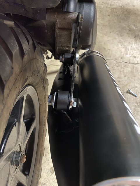

Post by Zino on Sept 6, 2020 8:34:04 GMT -5
The pipe looks sharp . I had the same fitment issue with the nut rubbing against the silencer. I just loosened up the all the silencer nuts with the pipe still on the scoot and retightened them down .
I stuck a washer under the front silencer bracket . I then just had a little room between the nuts and the silencer just a mm or so .

The pipe looks sharp . I had the same fitment issue with the nut rubbing against the silencer. I just loosened up the all the silencer nuts with the pipe still on the scoot and retightened them down . I stuck a washer under the front silencer bracket . I then just had a little room between the nuts and the silencer just a mm or so . Thanks is your mounting bracket in front or behind the pipe mounts? I just re checked and I don’t think moving the mounting bracket to behind the pipe mounts will work as that would pull the pipe too far out from the tire and it wouldn’t align well on the header bolts.

Here is he rear nut

Thanks Zino looks like the only difference from mine is I used the washers on the front of the mounting bracket as well so I’m gonna remove them from the front and hopefully that will be enough. I did use a washer behind and in front of the silencer mount as well.

Was at Lowe’s today and decided to pick up a couple M8 x 35mm non-flanged bolts. Installed them tonight and now my silencer clears without issues. I originally tried without the washer on front and it would probably clear but was still close so I just went with the non-flanged ones to make sure it had plenty of space.
