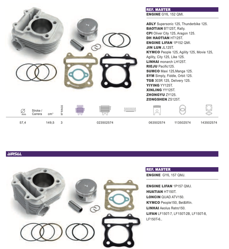

Post by guyfromeurope on Aug 5, 2020 15:57:46 GMT -5
Hi, I Just wanted to ask if the are any differences between 157QMJ and 152QMI ? I found two big Bore kits the are sold for the GY6 engine. I own an Kymco Agility city (2016) 125cc so it should be long case, Version B ( the head studs are placed wider than on the chinese engines) Does the 157QMJ have wider head studs or is it the same like the 152QMI? Thanks, Julian
Post by rocketdogiv on Aug 5, 2020 18:13:35 GMT -5
The only difference I know Guy is that the A Type is 54mm between the cylinder studs and the B Type is 57mm. There might be a difference in the cylinder height or the head height. To be honest, I'd be surprised if yours is a Type B with only it being a 125cc. Check it and see. Advertisement for parts can be very confusing,
Post by alindragon on Jan 25, 2022 17:32:50 GMT -5
Hey did you ever find an answer to your question? I was sent a 152QMI 125cc from an ebay seller and want to know if I can put a 171cc big bore kit in it or sell it and start with a new actual 150gy6
Post by 90GTVert on Jan 26, 2022 9:52:57 GMT -5
Most 125s and 150s should be able to use the same cylinders, aside from the B variants, and they have the same stroke.
Post by alindragon on Jan 26, 2022 20:00:39 GMT -5
I took the valve cover off and the rocker studs measure 54mm so chances are it will take the 171cc cylinder and jug. Hopefully I will not have to machine the crank case and it will slide in easy. Thanks for the confirmation.
