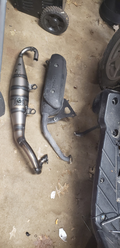

Post by laydback on Aug 11, 2020 4:59:53 GMT -5
IMHO tuning in stages like that is a wasting alot of time. Tuning the pipe to the stock cylinder to only retune when u install the 70cc and than retune again when you change something else seems like alot of time, effort and $ in jets, springs and rollers. Ive only built dio motors so maybe a jog motor is different. Thanks for your reply. Any chance you can elaborate on what 'you' would do or your familiarity with the build I described? My understanding is that the transmission and carb tuning would carry over to the 70cc cylinder, but perhaps I misunderstood something as I was researching.

The malossi cylinder and pipe are a good combo and overlap very well. I swapped on the malossi cylinder on 3 different builds in the last 2 years . One I left stock pipe, One Wild Lion ,one The Yasuni R The Malossi torque curve is very similar to stock just more power everywhere and revs out a extra 500 rpms on top . The pipe is going to move the cvt tune the most It will require a up jet So on the above Stock Pipe raised the needle one clip rich 5% up jet 84 on stock carb put in one notch up clutch springs . Wild lion same as Stock Pipe. Yasuni R Stiffer Springs Much lighter Weights same jet or maybe one more notch up 2-3 %
