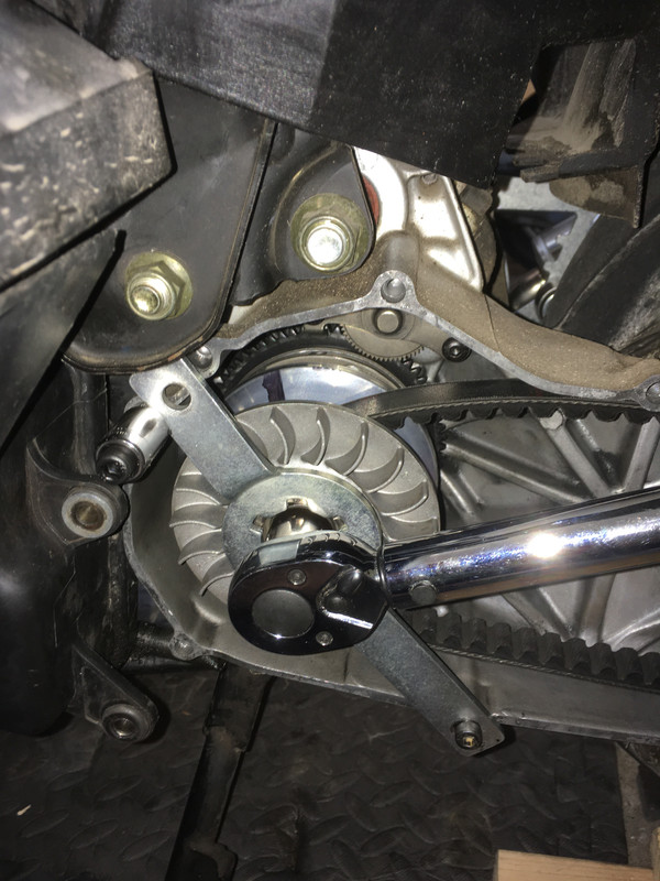

Post by laydback on Aug 11, 2020 19:34:17 GMT -5
Did they send me the wrong variator tool? Top bolt isn't lining up with the hole in the tool???

Post by Zino on Aug 11, 2020 20:27:00 GMT -5
Most of us dont run that gasket because we vent our cases To clean up the oxidation on the variator you can smooth it out with some 400 grit sand paper . Heres what I did for the variator tool Just used the longest bolt and a socket
Post by laydback on Aug 11, 2020 20:30:23 GMT -5
Most of us dont run that gasket because we vent our cases To clean up the oxidation on the variator you can smooth it out with some 400 grit sand paper . Heres what I did for the variator tool Just used the longest bolt and a socket Thanks. That's what I did too. The variator wasn't really oxidized that I could see...I actually have the new malossi multi var going in.
