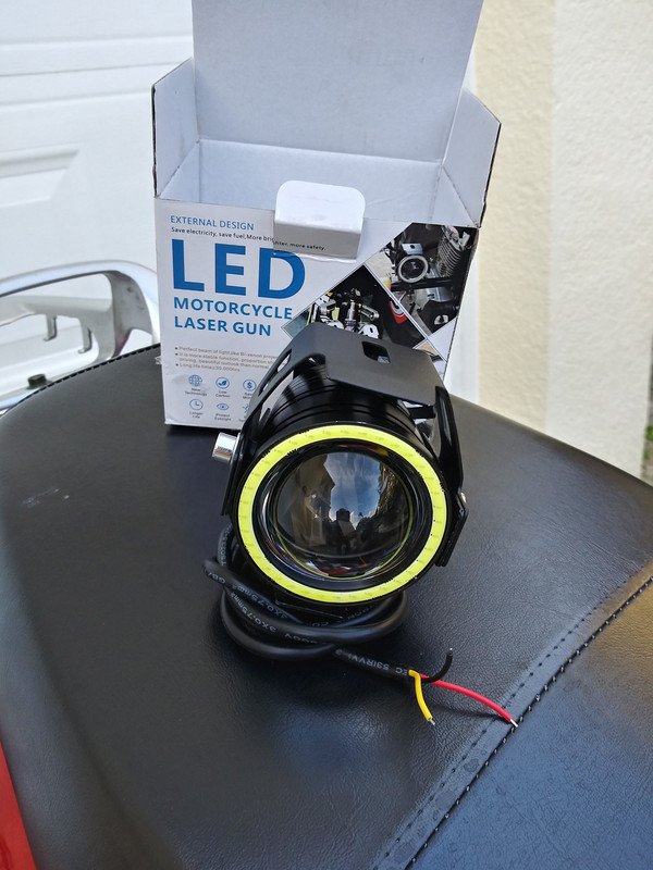

Got a set of these lights from a friend, after complaining about how my headlights suck at night. Should I wire them into my existing headlight wires, even though these do not have high/low beam? These are 3 wired, same as original headlights. But these have yellow/red/black and originals have white/blue/green. Any help is greatly appreciated.

Post by 90GTVert on Sept 2, 2020 9:36:19 GMT -5
If you are replacing the stock light, then maybe. If you are installing these in addition to the stock light, I'd say no don't wire them into the existing circuit.
The hi/lo switch may work out well for you. It depends what you want. The new lights may not have high and low, but it looks like there's an LED halo around the light. In that case, you could wire whichever color corresponds with the main light to low or high and the halo light to the other. So for example, you could switch to low beam for the halo only. That may serve as a good DRL. Then switch to high beam to turn the main light on. The only negative would be that you wouldn't be able to use the halo and main light together that way without additional wiring/switching. Most likely you'd have no need to use both lights together though and it can be a good way to reduce power consumption in the daytime.
