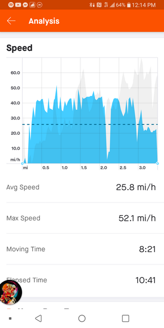

Post by honeyshark on Sept 18, 2020 20:32:33 GMT -5
So update time! Finally got the jets in and installed... Currently tunning the stock carb with the 84 main jet and a 46 pilot jet... Ran a tank and a half thru the little monster! Still just have the stock pipe on but managed to squeak out a little more than 52 mphs! So tomorrow im going to take the head off to remove the gasket i originally installed amd go for the copper spray gasket to reduce the squish followed by installing the carbon fiber reeds and a leak down test... If all goes well then ill slap on yasuni R pipe to see what she got... Bwahahaaha... Thanks for all the help you guys have given me!
