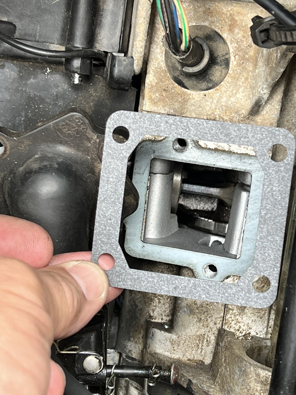

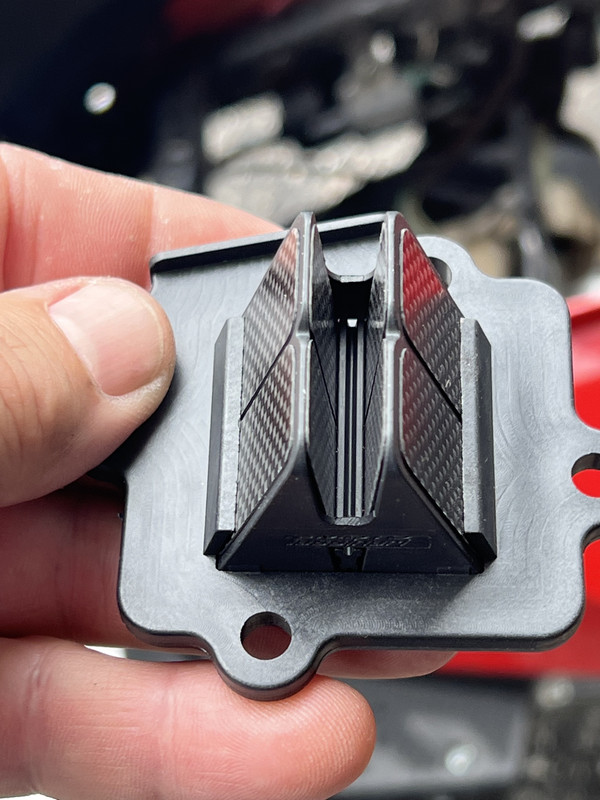

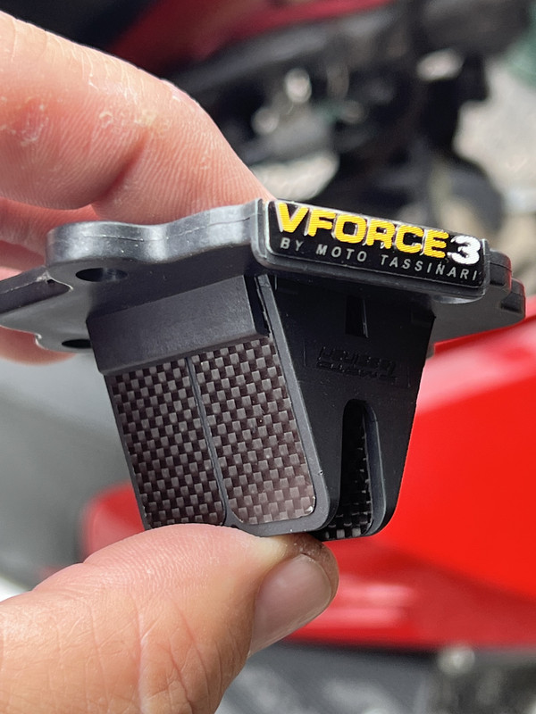

When you order them fancy reeds off AliExpress the part they omit from the instructions is what part of your ass the gasket is supposed to be placed in. Oh well. I installed them using the old gaskets like I’ve always done and then tried to start it. It barely starts even on n choke. Damn. Ok figure I have a vacuum leak. Take it apart, study, reassemble. Nope. Take apart, grey gasket goo around base, reassemble. Now the hard part, wait for 24 hours. Did that. Start. Same crap. It’ll run on choke but die very quick on regular. Opened idle mixture screw (no lie) about 5-6 full turns and it will idle without crapping out. I think I need to swap up to a bigger idle jet. Then I’ll adjust again. Until then I need to renew my registration AND get its annual PA safety inspection. Check lights, check brakes, charge me $20 and send me on my way. Thanks.
Post by aeroxbud on Jul 19, 2022 4:11:54 GMT -5
Usually in my experience the gasket goes on the case. Then there is a rubber ridge on the intake manifold which seals the top.
