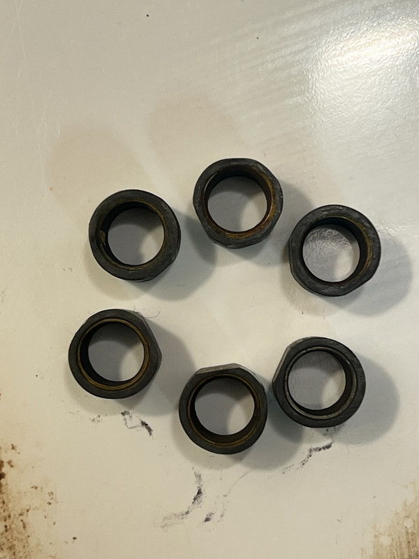

These are some old stock 4g round weights I had in my scooter. I swapped them out today for 5g Dr. Pulley sliders. My top speed is back up to 53mph but I have a laggy downshift around 30mph where the rpm’s drop from 9>7k and then climb back up. Guess I’ll take apart the torque driver and swap some springs around again. I may have to drop back to 4g sliders or mix 4/5 for a 4.5g average. It’s aweful nice being able to cruise at 50mph now though at 8,500 rpm on flattish roads. I missed that. With the worn out 4g round weights I was maxing out at 10k/47mph.
