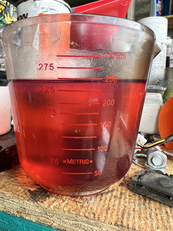

Post by 90GTVert on Sept 10, 2022 18:22:59 GMT -5
I ran the 78 jet all winter last year with the old used Corsa jug. Never had an issue. I’m wondering if it’s a fuel flow issue. 🤷♂️ If you wanna try a flow test, I was getting 375-450ml of fuel transfer in 30 seconds. Depends on the exact combo. This wouldn't tell you what was happening at WOT for sure, but if you keep a vacuum applied you could get a sort of best case flow rate. You shouldn't have to be too precise and you shouldn't need that much flow. I was getting about 150ml at best in 30 seconds when I had 3/16" on the outlet of my filter and 1/4" on the inlet and that was enough for a 28mm carb with a ~150 main jet. Ryan said he got 175ml in 30 seconds and he's got a big 34mm carb and larger jetting with all 3/16" hose and no filter other than the in tank screen. If you can consistently get 150ml in 30 seconds, it's probably plenty based on this info. FYI my setup is 2.5 gallon tank with 1/4" barb, 1/4" tygon, 1/4" briggs shutoff, 3/16" tygon, 3/16" or 1/4" filter, 3/16" to carb. Use the same size fuel hose before and after the fuel filter! That was way more important than I would have imagined with some types of filters.

Post by captincvmn on Sept 11, 2022 14:17:45 GMT -5
250ml/30seconds At that rate I’d run outta fuel in a very short time. I’d say it’s not blocked. I’m gonna go with the LOSS (Lack Of Suction Supply) theory where my WOT is causing the petcock to shut down.
