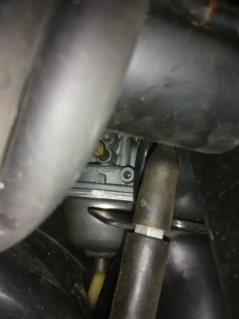

The good folks at Adly saw fit to use a Mikuni branded carb on the RT-50. I honestly expected some weird no name generic. Well I do declare! Wonders never cease. Lol. Is it real? Is it a knock off? I'm sure I find out in just a bit.
Post by wiscootsin on Sept 19, 2020 8:31:38 GMT -5
The eton beamer, adly jet50 and United motors minarellis I've had came with mikuni carbs.

Right?! I was very surprised by that. I looked all over the net for a couple days to see if I could find out what was on there. I finally just had to crawl under it. Pretty happy about it.

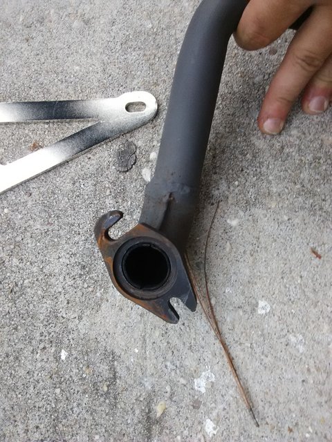

I expected to see a restrictor in the flange of the old pipe, but that didn't seem to be the case. This thing was heavy as a friggin rock!

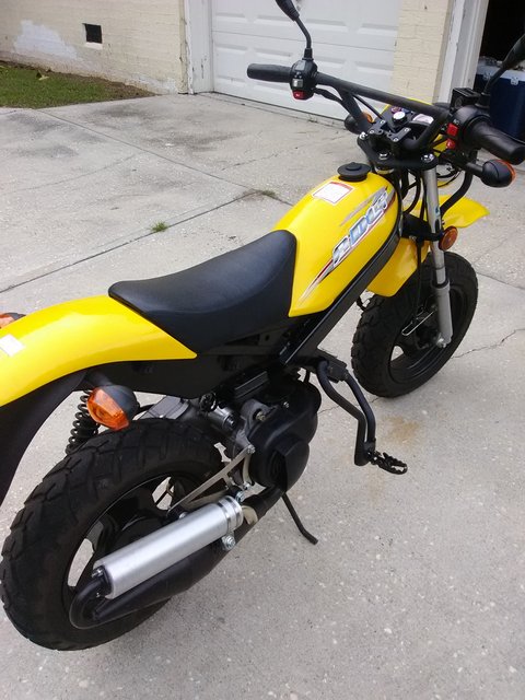

Pipe went in alright. Took a few tries and a bit of jiggling but it finally came together! I wasn't sure about looks since I was more concerned with function, but I really like it.

So, only two slight problems. 1. I had to take off back fender. Old pipe was part of its support and without the pipe, the fender was dragging on tire. Gonna roll by hardware store tomorrow and rig up a new support. 2. I'm a little uncomfortable with how close the silencer is to the carriage bolts. They aren't touching, but they are a little too close for comfort. Will see if I can add a spacer to the silencer brace that will give me a little more separation.
