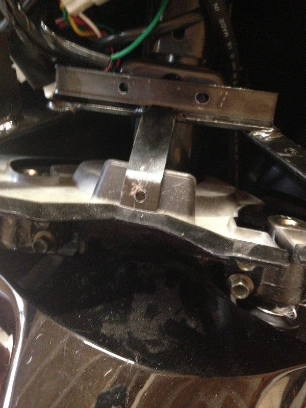

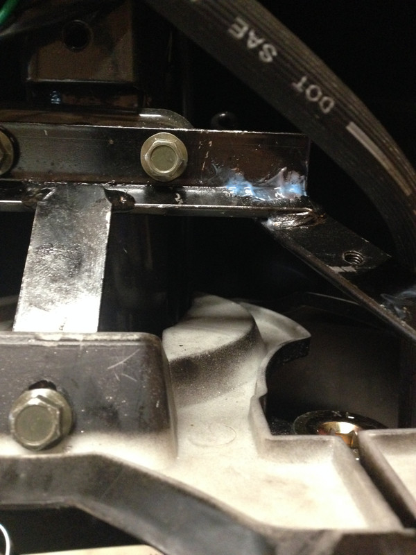

That's easy. My problem is a steel plate and surrounding plastic fender. I'LL get it together eventually. I'm hoping anyone working on an IceBear reads this and takes photos.
kevino
Post by Steve B on Oct 20, 2020 9:45:00 GMT -5
Kevino, Are you talking about the wheel well cover by any chance? Those can be a pain to get on sometimes.

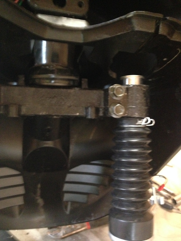

Not sure it's the right photo. I set the shocks at 15mm above the triple tree tops of the clamps. Then started two phillips, one on each side of the cowling. That's when my back rebelled and I had to quit. I'll finish tomorrow.

Does this look right? Still hoping someone knows the torque setting for the 12mm flanged bolts kevino

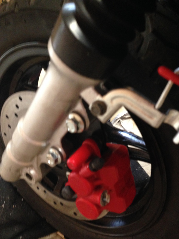

The wheel is back together and on the frame. I had detach the brake line. It's reattached but how do I bleed the brakes? Also is the black, metal item in correctly. If it is is the brake line in the proper spot? TIA, kevino
kevino
https://www.youtube.com/watch?v=04dSGwAssRA
Posts: 358
Post by kevino on Oct 24, 2020 12:09:18 GMT -5
I forgot to mention the tube was still in the wheel. It made threading the axle bolt easy. I had to seat the bearing and seal using a large socket and small hammer.
Also, do I use standard brake fluid? kevino
Post by aeroxbud on Oct 24, 2020 12:20:24 GMT -5
You should have the brake pipe so it exits from the rear of the caliper. That way it won't rub. Loads of videos on YouTube, which show you how to bleed brakes.
