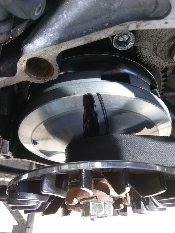

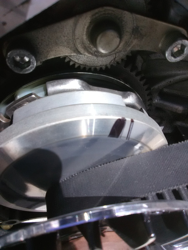

Post by Deleted on Oct 24, 2020 12:19:26 GMT -5
Okay, things are getting interesting. Pulled cover off today. Just making sure everything is happy a week on. Belt looks good. CVT box is hot, but not overly so. Not a ton of belt dust in there. Everything looks pretty happy.
The RT is absolutely flying along over the last week. Hit new speeds and am very happy with it. While doing my check, I noticed that I don't seem to be getting full travel with the belt. Pretty obvious ringwhere it's been riding at high speed. Makes me wonder what might be holding it back.
Variator boss is no longer the issue. Made sure when I was shimming that variator could close completely. I figure it could be the 5.5 weights are quite heavy enough, or perhaps my rear pulley sheaves don't completely open. That might mean the torsion controller is too much, or could be the grooves on the torque driver.
It also occurred to me that perhaps the Adly 878 belts are purposely a little too short, but I think If that were the case, I'd see a lot more wear and tear.
Well, here goes the sharpie trick on both the variator and rear pulley. Let's see where we end up. Will post some before and afters.

Post by Deleted on Oct 24, 2020 12:24:00 GMT -5
Before

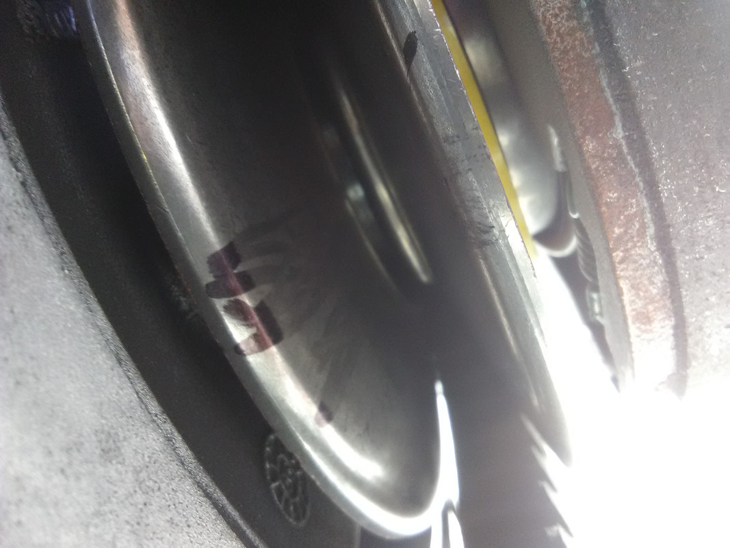

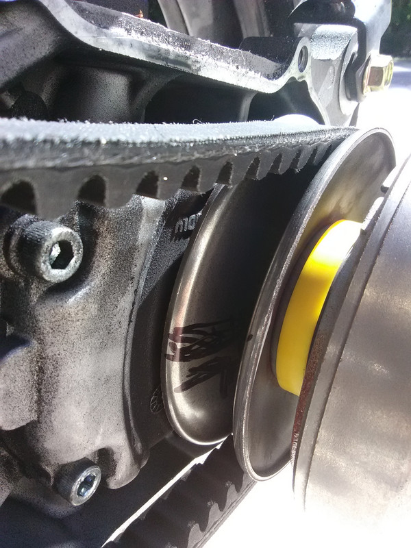

Post by Deleted on Oct 24, 2020 13:13:40 GMT -5
Well, we certainly aren't getting full travel. Not sure if it's the weights or sheaves. Here's the variator: And not the greatest shot, but here's the sheaves. Marks are gone, so it looks like belt is traveling all the way down. Maybe it's the grooves. Hmm. Is it the most important thing in the world? Not really. I'd just like to know what's going on. That is likely a project for another weekend.
Post by aeroxbud on Oct 24, 2020 15:20:30 GMT -5
Chuck a set off heavier weights in to see what they do. Perhaps about a one gram.
