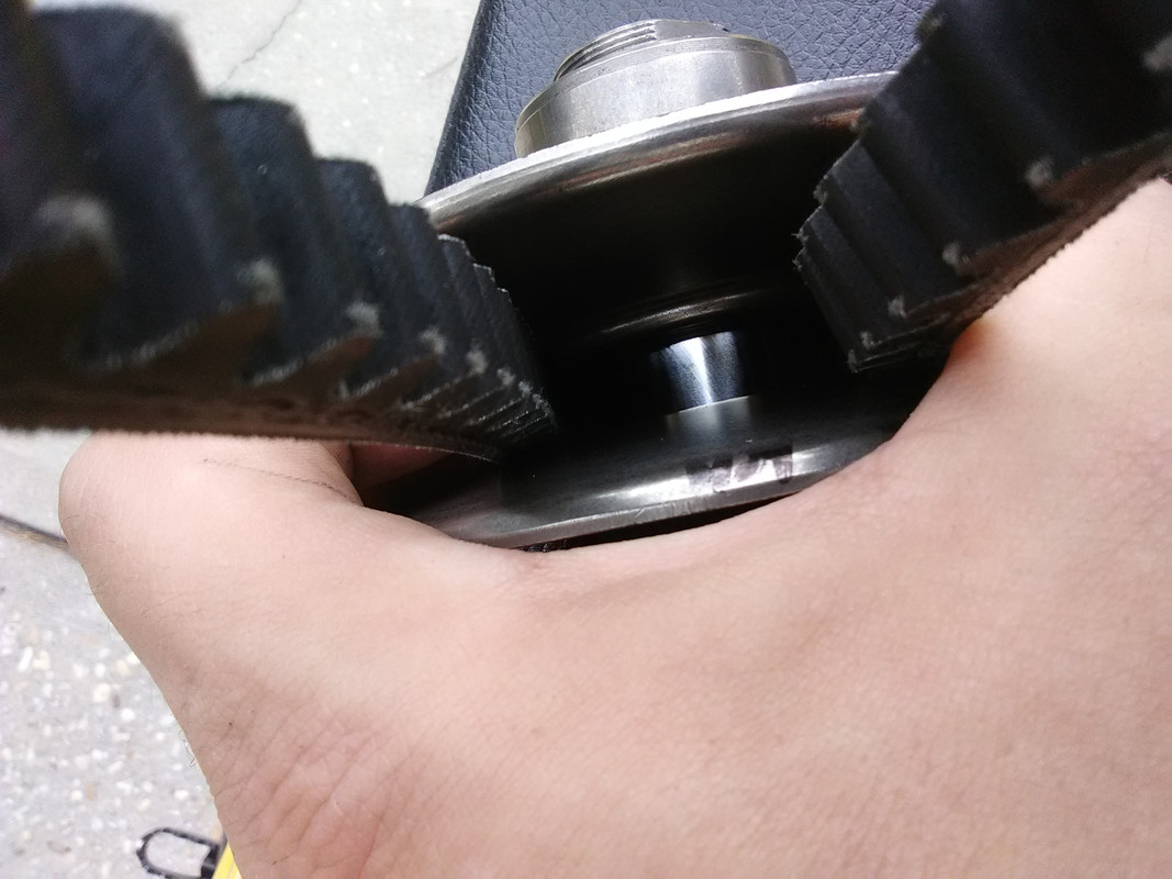

Post by Deleted on Nov 1, 2020 12:14:15 GMT -5
Well, I've done a week's worth of trials using weight combos from 6.5 down to 5.5. Acceleration was affected by changes, but speed and belt trav remained the same across the board. Pulled apart the clutch and started looking at rear pulley. It seems that the hub in torque driver is holding me out from achieving top gear. In fact, the distance created by the hub roughly correlates to the amount of sharpie left on variator. I also checked to make sure the clutch itself wasn't keeping rear pulley from fully opening. Nope it doesn't cause any issues. Driver opens fully. So... I ordered a new torque driver. Weights have been reset to 5.5 since that seemed to be the best setup so far. I'll attach this problem again when the new torque driver arrives.

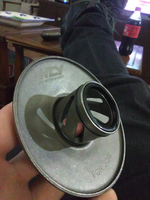

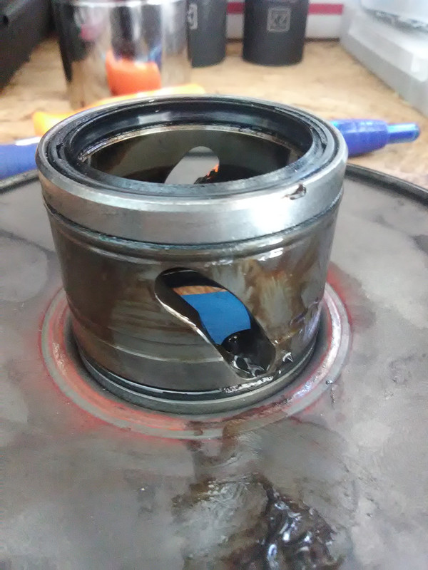

Post by Deleted on Nov 8, 2020 11:42:17 GMT -5
Added NCY 1200-1033 - 33mm I.D. secondary slider to rear pulley. Was completely shocked at how easy it was. Just two pins on the Adly. Since all my parts are marked Jet 50, I'm pretty sure that's the case with all of them. Anyway, I chose the middle groove for initial setup. We'll see how the RT likes it and adjust. I gotta hand it to Adly/Her Chee. They didn't try to short cut the grooves on the original sheave. They go from o'ring to o'ring.

Post by Deleted on Nov 8, 2020 13:26:59 GMT -5
Well, she lost maybe a half a step on acceleration, but it is so much smoother. I was getting slight lag around 25/30 with the old driver. That is completely gone now!
