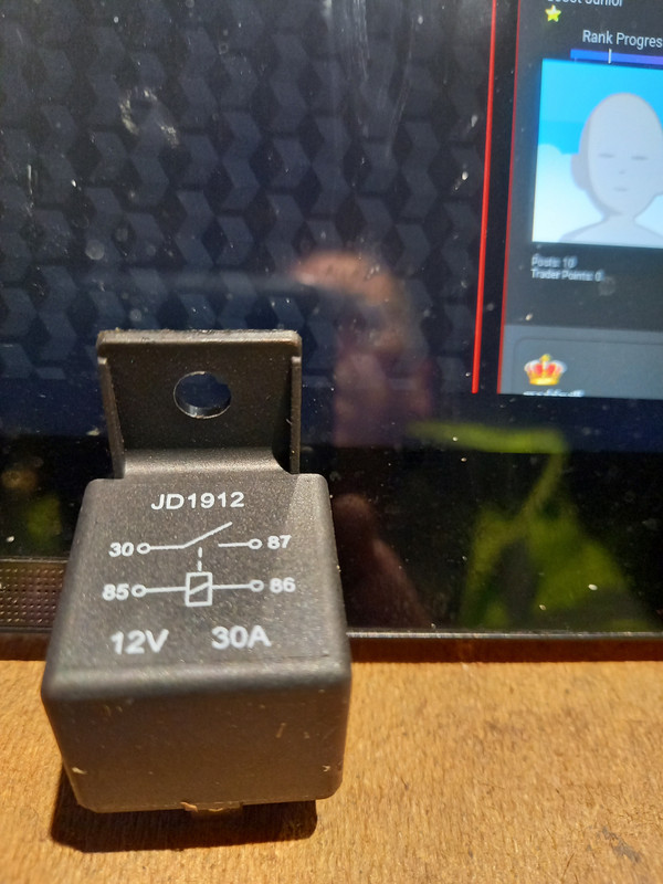

Maddevill,I got a few relays for my jog before I ditched the electric start,pennies off flea bay now gathering dust PM me your address and you will get a not so secrect Santa thingy. Geoff and here's the tech spec you need to buy one from an auto store for a few dollars more.
Post by maddevill on Nov 9, 2020 19:57:22 GMT -5
Hey thanks for the offer. Unfortunately my starter relay is quite a bit different than that one.
Mad
Post by FrankenMech on Nov 10, 2020 1:54:34 GMT -5
A regular old style FORD starter relay will work, they just look different, and they can be purchased at any auto parts store.
