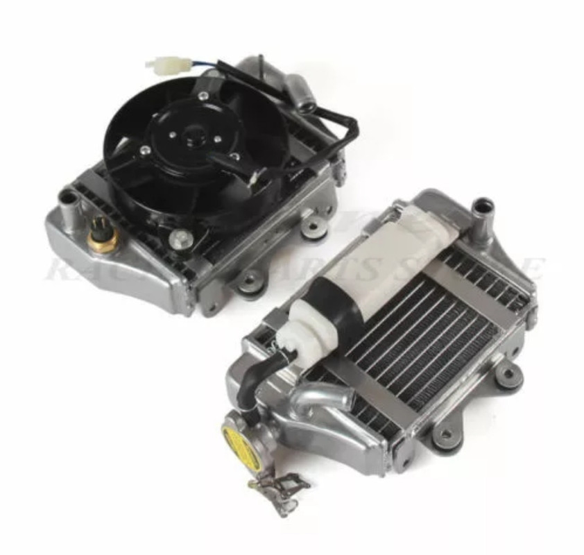

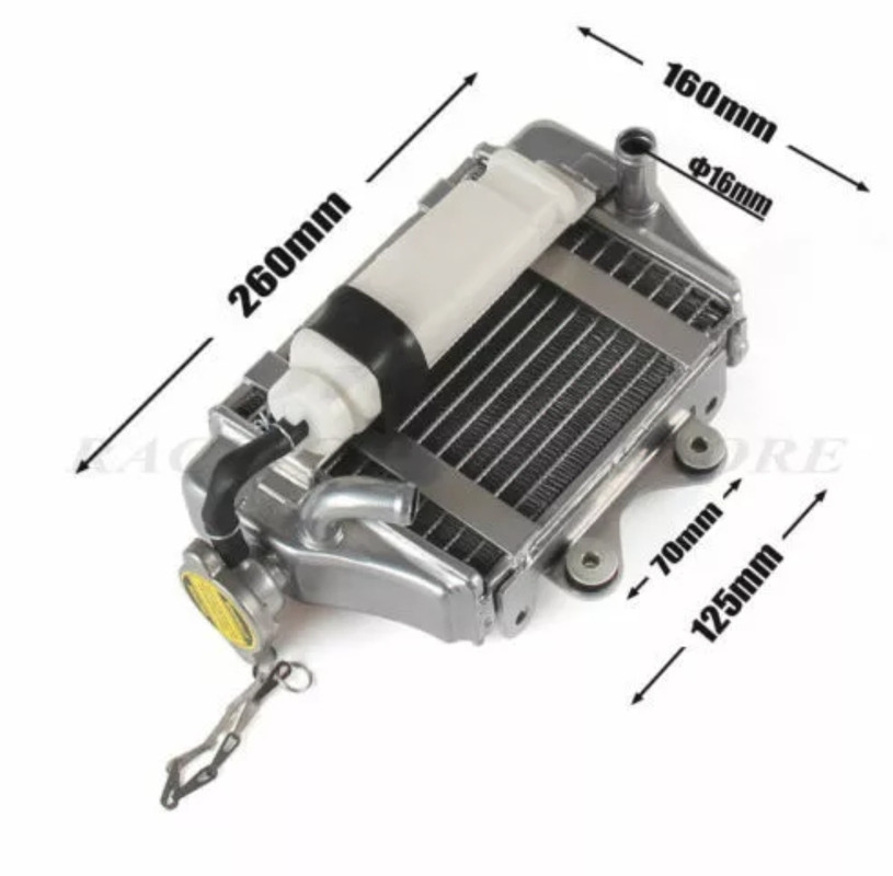

For the LC convertion however, I'd probably go same route as you did and build my own RAD bracket etc. hence the price is way cheaper(ebay) rather than buying the set from the store.It's a winter project anyway,so i guess i have lots of time to fiddle with it. I easily got bored with my AC build and want more acceleration and easy 63mp with out WOT while cruising on highways. I'm hoping that It can easily be achieve with this furture build. A lot cheaper than going with MHR kit. This TPR cylinder+crank kit is same price as the rc one crank alone lol. Ps: I am not saying MHR product are not worth the money hence i also own few MHR products which performs fantasticly well for street build.
